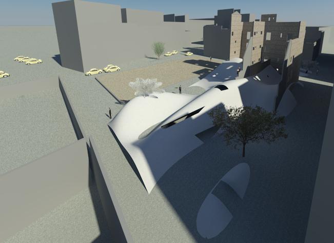

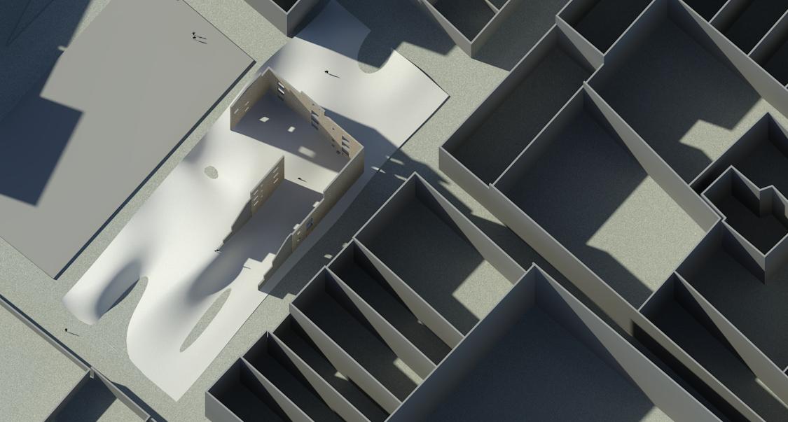

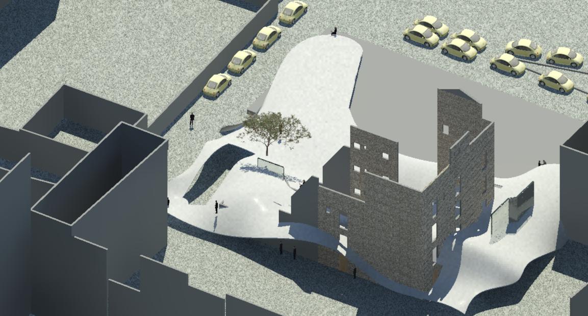

my suggestion for a new public floor in a site at palermo, italy - seem to create great challenges for the model generator inside revit, several of my tries have only delivered the sad message "unable to create form".
this is how i tried making it (see attached pix). with 3d polylines arranged parallell in plan and individually deviations in z-axis/height that together form a wavy surface i imagine should be construced from concrete shells.
i want to have the thickness up to 400 millimeters - but it does not seem possible..

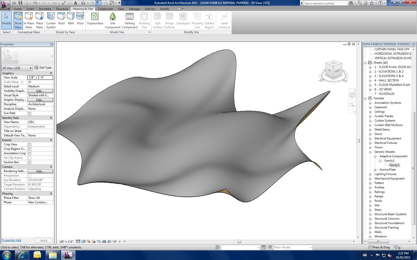

I think what you need to do is import your model into a project as a mass family
-then under "Massing & Site" go to "Model by Face" and click on "Roof"
-setup your roof construction which will give it it's thickness
-select the mass
-click on "Create Roof" on the tool bar and there you go. I've created a roof that is 3" thick in the attached image. I did find that any thicker that I received an error "can't make roof". Not sure what that is about.
