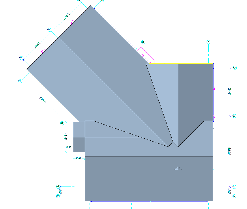

Hello,
I am in need of some advice in regard to the roof I've attached.  I currently have it as four separate roofs, and when I try to join them to make one roof, nothing happens.  I think this roof may be too complicated to make as one roof.  Three of the roofs have the same slope, while the 4th roof has a different slope.  Any tips on how to proceed and make it one roof?
~ Thanks!

Any chance you could post your slopes? I think this is doable.
Edit: Nevermind, ltake a look at this: http://screencast.com/t/R57kTF8d

Hello,
Please refer to the new image I attached.  Roofs A, B, and C all have slopes of 4"/12".  While, roof D has a slope of 3"/12".  Also, the eaves are not going to be at the same height.

if you are trying to have roof C land on the ridge of roof D, then manually edit the shape of C to do so. If C is under D, I guess I don't fully understand your question.

rkitect: Thanks!... Your tutorial explained it all.
