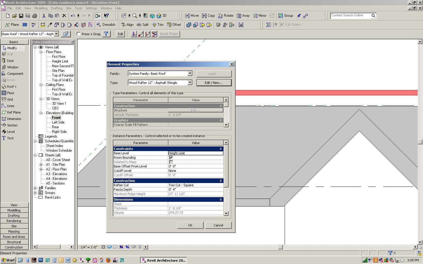

Check this image. you can see my flat roof set to elevation "height limit"
at 0'-0" offset from level, but it still is like a foot above the line. (see line my mouse icon is pointing too...) this happens for my pitched and flat roofs. am I missing something?

sorry here is the screen shot
Fri, Jan 14, 2011 at 8:15:31 AM | roof placed not in plane its set at.
Did you do this roof with overhangs and you picked the edge of your wall for the roof?  Think about it, better yet, cut a section.  Where is the roof at the wall line?

Yeah, I think thats what it is. its always a toss up which plane the roof ends up with the command choices...its no big deal though as, like you said, a simple section and move will get it in the right place.
