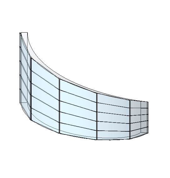

Hi all:
I need help in my project. I have been trying to create a curved curtain wall which is making 80 degree angle with the ground level. The curved wall is also making a slope from it's highest point to it's lowest point ( please see the attached image). I tried 2 options
1. first I created an in place mass in the project and on the face of the mass I placed the curtain wall. Unfortunately the grid lines are not showing parallel with the ground and it's not leting me to change the direction!
2. I tried to create a conceptual mass in Revit 2011 and then used intersect tool to create the grid lines. The horizontal lines are showing but as soon as the grid line on A hits  the sloped surface it is not creating the grid line.
If  someone in this forum can help me that will be appreciated. Thank you all in advance.

it's a tricky one which I must admit I haven't quite resolved myself.
 I've done it in two ways
(1) Create a mass the shape you want. This is quite easy, in-place mass, draw curve etc and then in the 3D view you can drag the end profiles (see attached image), then pick curtain system, pick the face of the curved wall and it will create the curved curtain wall. HOWEVER this isn't quite right as unfortunately it splits the system equally and the transoms (mullions in Revit terminology) will follow the same profile i.e. they will slope when you probably want them to be horizontal
(2) Create a curtain wall in the 'typical' manner, split the system and use the Empty System Panel to effectively cut out the sections you don't want.
I'm not sure if that helps as all and I'm by no means a advance Revit user so that's about as far as my knowledge goes I'm afraid

Hi Steve:
Thanks for your reply. I tried those but it is not creating my grids on the surface where the line is meeting the sloped surface. I wiah I could found it! I have gone to the books, u-tube but nothing is helping me!

Has anyone figured this out? I have a wall alomst identical in geometry to the one in Sigma's original post. When I apply a curtain system to the mass I created, all of the 'vertical' grid lines are angled, not vertical. I have scoured the internet for videos or forum suggestions, and can't seem to find anything.
Has anyone figured this one out?
Thanks a lot.
