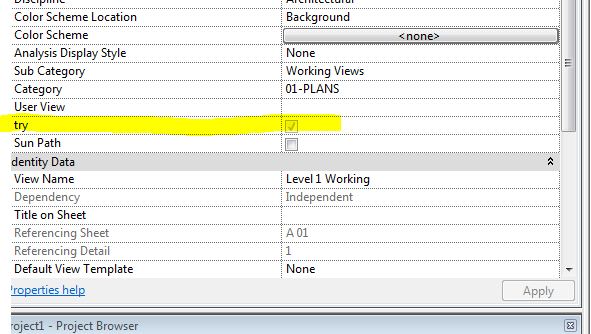

One thing has confused me for a long time.
 When we set up a yes/no question, by default it comes as grey checked. We can uncheck it or check it again. But it's no longer grey. Any difference here?

I am talking about a project parameter I added in the central project file.

all yes/no parameter created for a project parameter come as this way. You can have a try and you will see what I mean. I didn't select mutiple things.

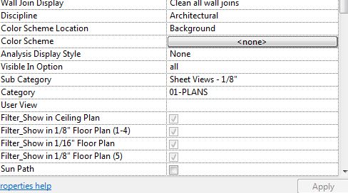

I reiterate this, I am not selecting anything, just in a view, and I add a yes/no parameter to all the views. It comes as grey.
see attachment

Then I guess it is in a state of limbo, The box does not know weather it is (yes or no) til you tell it.
 I didn't read all the threads, my mistake.
I gave it a try and mine is grey too.  This is the only conclusion I can come up with is the "limbo" state.  When you assign a Yes/No paramter to something say a wall, do all walls take the yes or the no? or is it waiting for you to tell it one way or the other?
The grey is an obviouse way of saying "hey, you havn't addressed me yet, Am I yes or no?"  and yes is the default.

ok i agree with cadman, when you first set  up this project parameter, by default, they are grey since nothing has been assigned yet, so you have to phyically un-check the checkbox, check it again to determine what you want for that "view" so the grey color means it is a undetermined state to my understanding.
