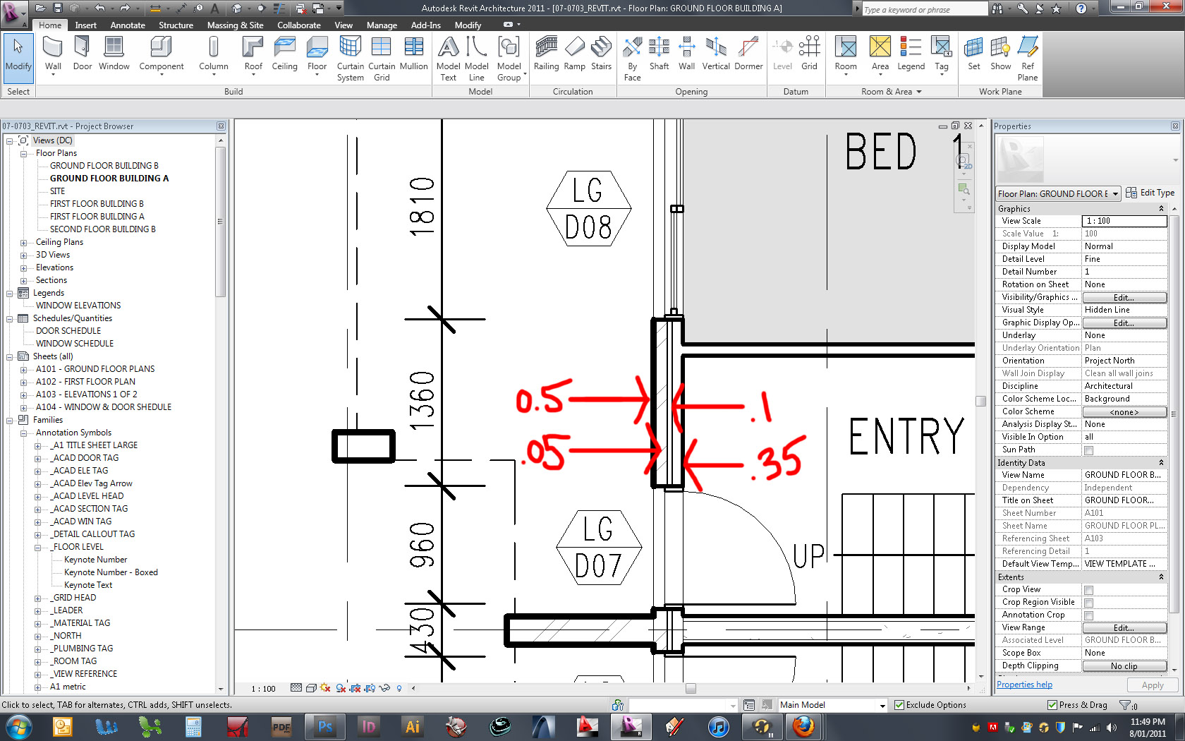

1. Multiple line weights to single wall types!
I'm not sure about the USA but everywhere else in the world we use different line weights to differentiate materials: Timber - 0.35, concrete 0.5-0.7, lightweight cladding - 0.15 and so on... the idea that we are made to scour the plans with the LW tool overwriting line weights is crazy… please look at how Archicad approaches this.

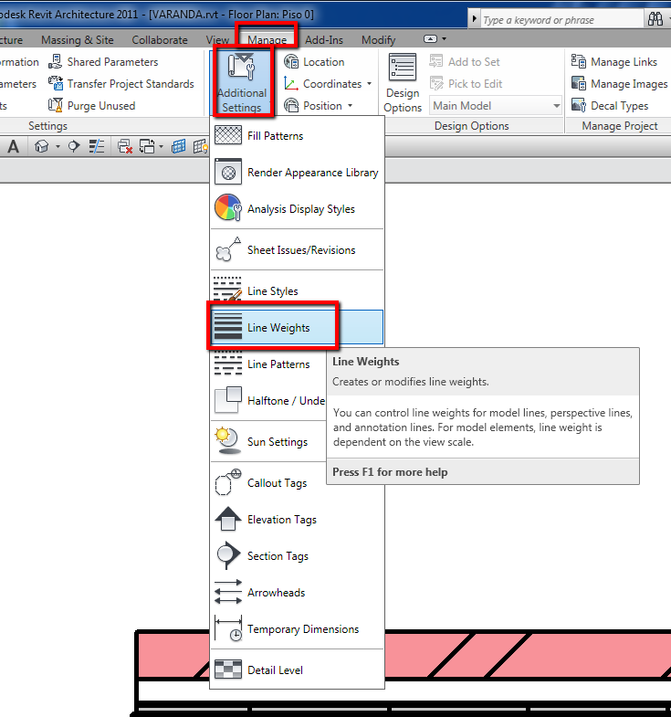

Revit is not Archicad (thank God), you can control and create all your line weights.

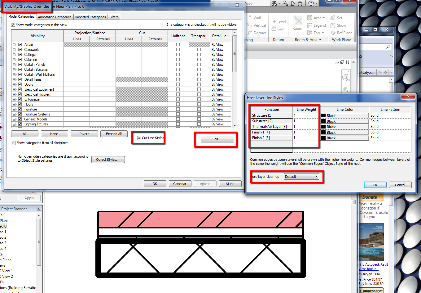

Thanks for the reply mate... but again, not the level of control needed.What you've pointed out is a universal cut line overide, not an individual control. See the attached image... this is the most standard, commonly drawn wall in the world and I needed to use the Linework tool to create it correctly. I'm just saying that line weights and fill weights should allow further refinement through the Edit Assembly dialog box.Theres a preview right there... why cant we overwrite them there?
I know I shouldnt mention the 'A' word here but seriously, this is exactly what can be done in Archicad.
