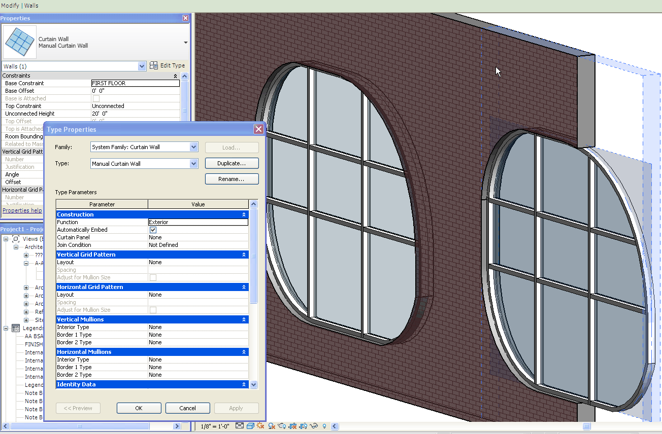

Here is a "manual" curtain wall set to self embed in the wall.  I copied it to a second location that is partially in the wall.  You can look at the properties.
