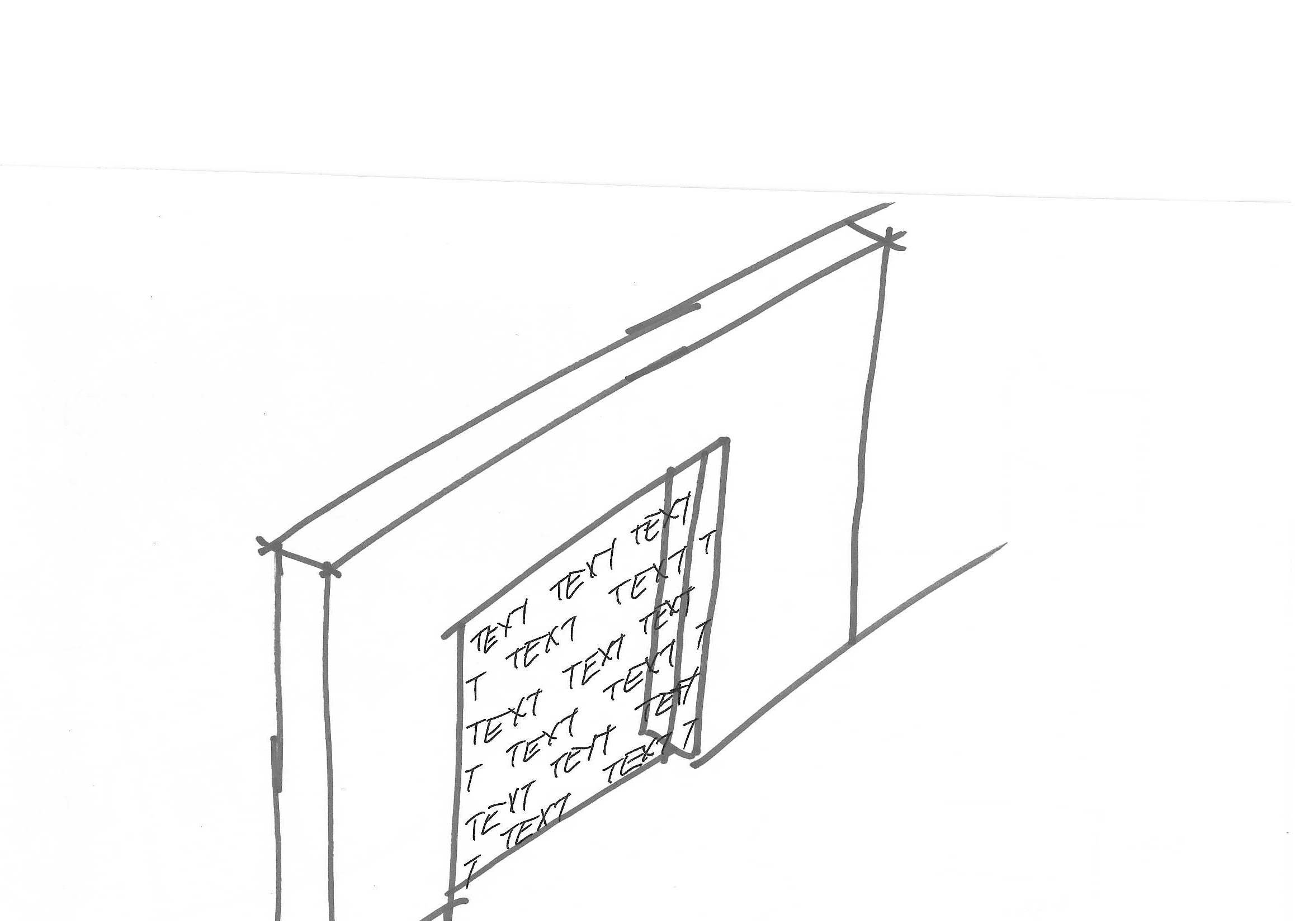

HI GIZMOZ/
IN REVIT 2011
any ideas on this one?
how can i avoid the back to back effect when creating a glazing OR "FENCE" type wall with RENDER materials that have cutouts with letters- i want to have the effect of a wall that is made of letters and without the repetative text on the other "skin" of the thickness of the material...
ie- is there a way to create a surface that has not thickness.. and thus give it a material?

Try using the Split Face and/or Paint tools and just apply the material to one side of the surface?

hey
was a good idea-- but not working out for me..
it doesnt give me a transparent layer aroudn the text..

Try this:
Set the default material of the wall to a transparent material?
And you could try this as a material:
Take a look at the Wood Stockade material in the library - use it as a base.
Create a jpeg of your repeated text - swap it out with the image map of the Wood Stockade material
Invert the colors of your repeated text jpeg so the text is white and the background is black - swap this out with the Cutout image map of the Wood Stockade material
Paint the one surface of the transparent wall using the new material - hopefully works? :-) I haven't tried it but it seems it should work.

if i understood clearly- i should create a totally transparent material- and make that the base to the host wall---
and then create the split face and attach my a text material--
well- i did it and it worked!
WELL DONE!
great advice!
thanks BM
