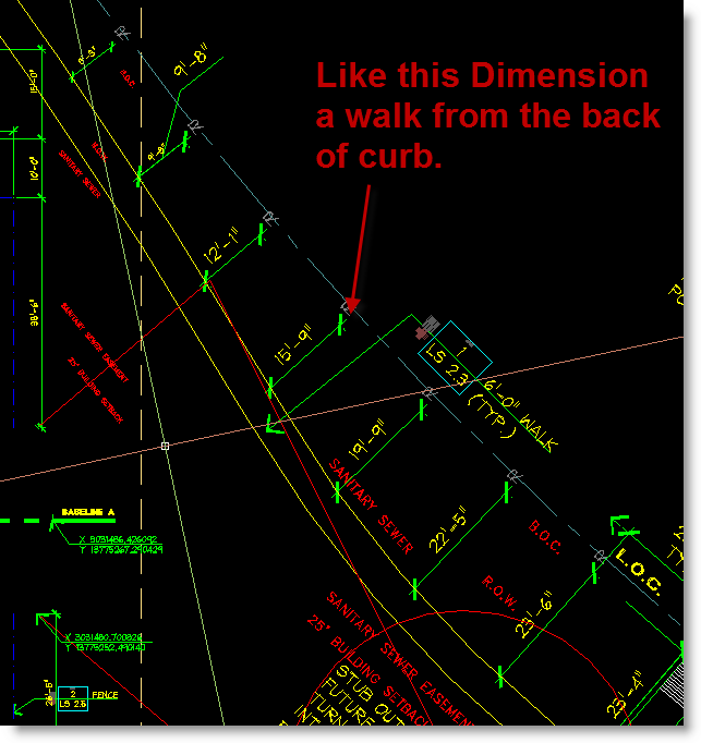

Has anyone tried using levels to do their sitework? Like every 6" add a level to match the topography? Just a thought and wondered if anyone has tried it before. I ask this question because the Autodesk support page states that you should/could use ramps for curved and straight walks. This seems kind of useless to me unless you have a base level and top level to end the ramp on.

Thanks, I don't have much experience with Ramps. I have been using the topo and subregions, but that makes it a little hard to draw dimensions to for landscape layout plans. So I was trying to figure out how to use the ramps. Do you think there would be any benefit to using levels to do sitework?
Tue, Dec 28, 2010 at 1:51:30 PM | Levels and Sitework
Trying to do sitework with levels would be crazy.
What are you having problems with?  Dimensioning should not be any problems.  You can always dimension point to point anywhere.  If you have topgraphy, spot elevations work.   Remember, you can always add annotation lines and dimension to those as well.

I have learned to model in place a parking area (floor with curb profile "modeled in place) with some islands, using floors for sidewalks, retaining walls, and now I was looking at doing a layout plan or just trying to dimension a curved sidewalk from the back of curb. I was looking for some answers when I ran across the autodesk website describing how to use ramps for walks.
Tue, Dec 28, 2010 at 2:33:33 PM | Levels and Sitework

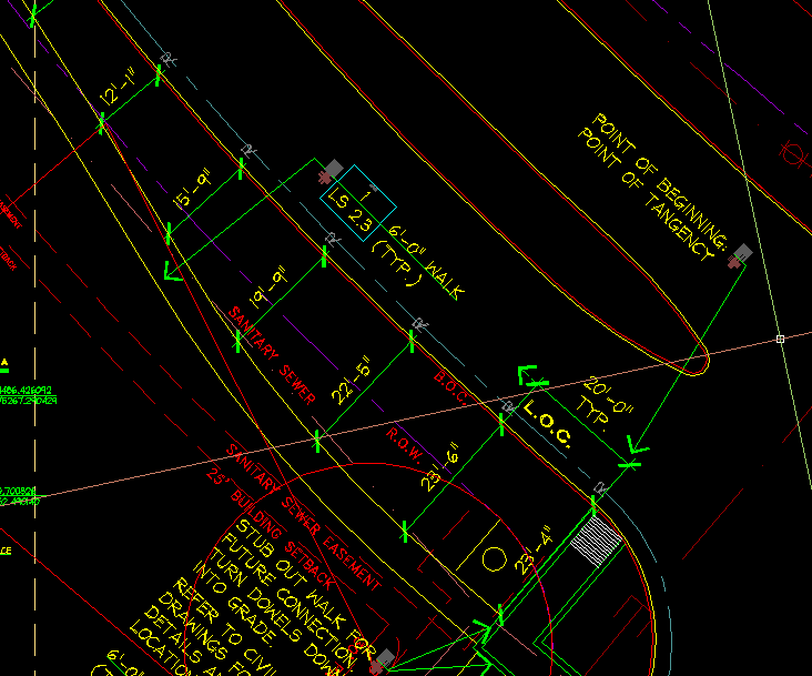

For concentric curves, just place a perpindicular line and dimension the intersections.
The image you show is poorly dimensioned.  Given two lines or arcs, a dimension across the two is meaningless unless it is located somehow in the perpindicular dimension.  If this is a station / offset dimension, the stationing would locate where teh dimension is.

Yes, the xref was missing so it didn't show the back of curb, and you do not see the some of P.O.T (Point of tangency) and P.O.B (Point of Beginning) and that each dimension was every 20' from a known point, but none of that is what I was talking about. Assuming that the curved line is the back of curb, I was trying to figure out how to draw a dimension that is perpendicular from the curb to the walk.

To be honest, sitework is one of Revit's weaknesses.  The mechanics of topo do not mesh well with the rest of the program.
How are you building your curbs and walks?  Here's one of many work-arounds:
If you are using subregions to define different materials, well, you can edit the sketch of the subregions you've drawn, select all and copy the boundary lines, cancel the sketch, start a new floor (for example,) create by sketch, and paste the boundary you copied from the topo subregion.  Now a concrete object will mirror your undimensionable topo lines... you could set the floor on a level below your topo, set it as an underlay, or simply  override your graphics to wireframe so it displays as redundant lines in plan...
You can also later "modify sub elements" of a floor or roof "sidewalk" to give it heights that match slopes on the site.
