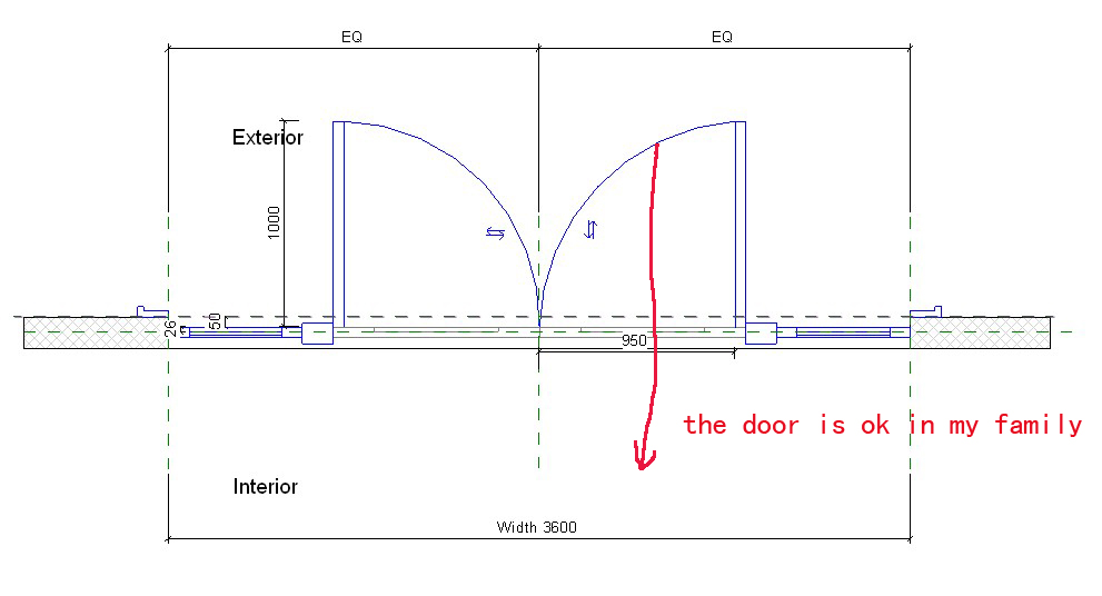

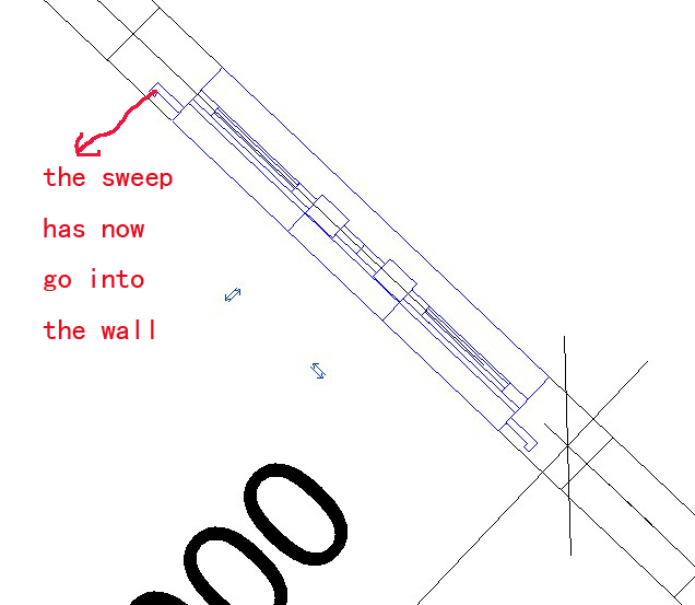

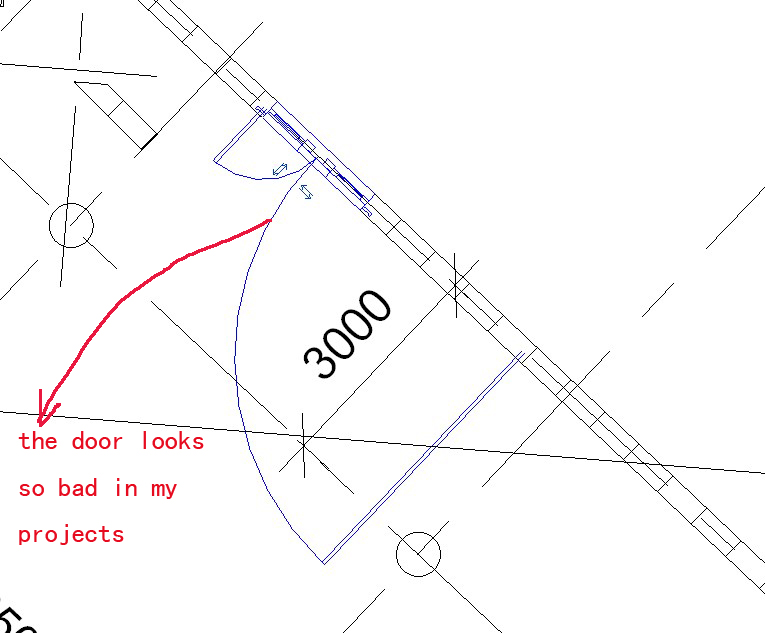

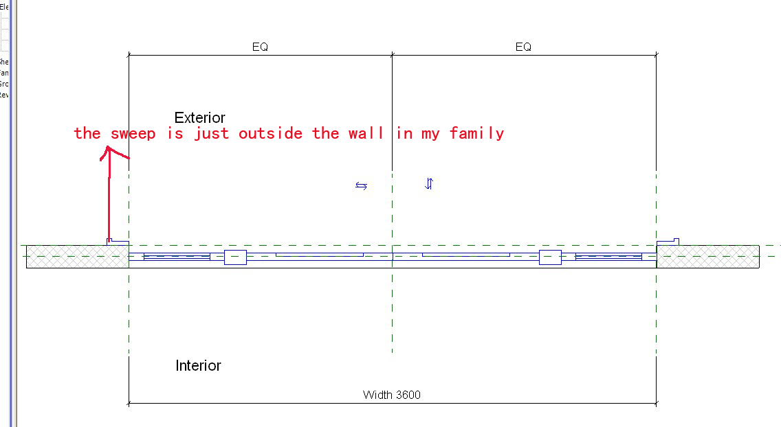

look, I have made a door family,and it looks quite good in the family, as picture 1, and then I inserted it in to my project the sweep have go in to my wall.
and when I finished door swings in my family, it still looks so bad in my family when I inserted into my family.

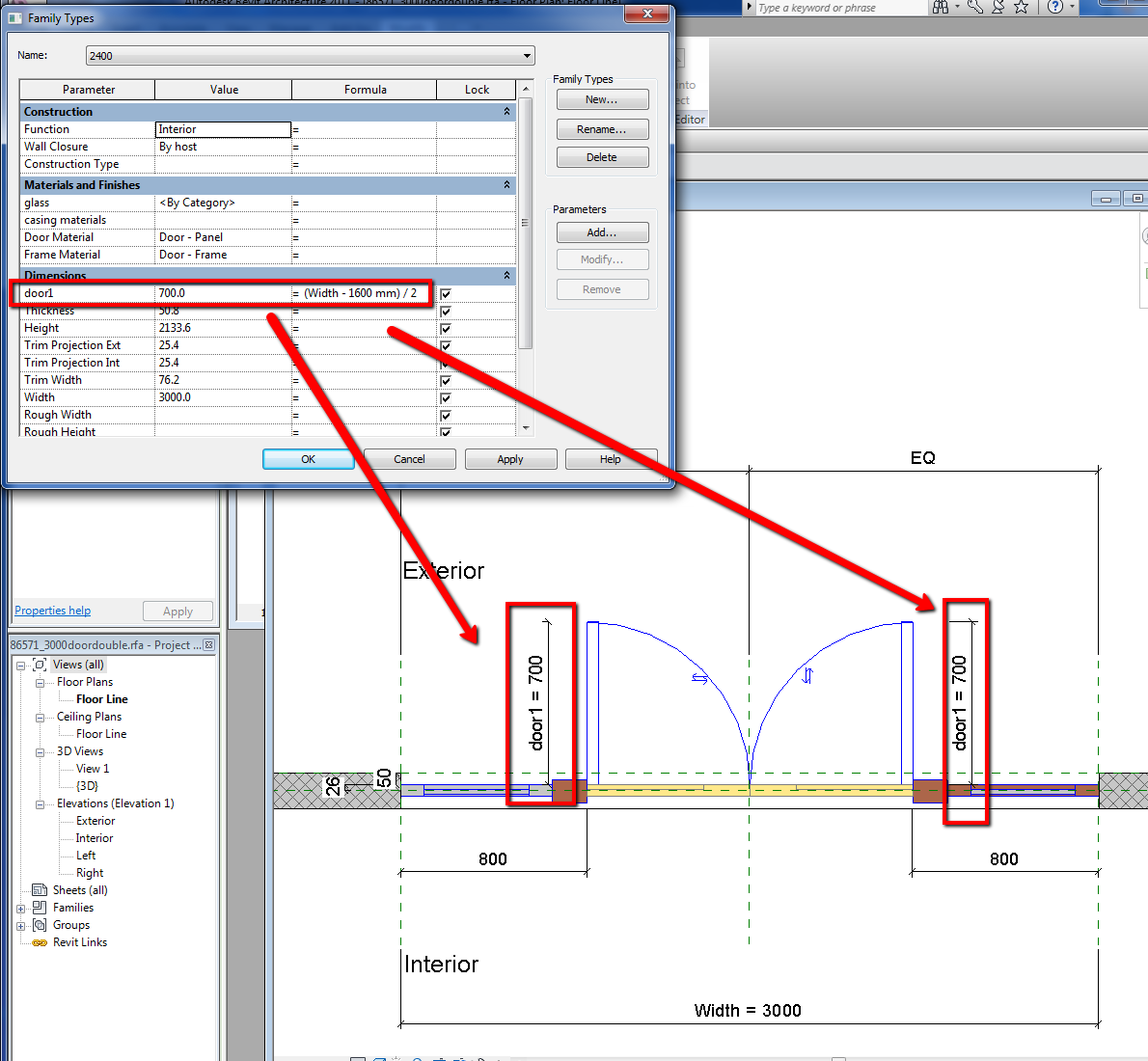

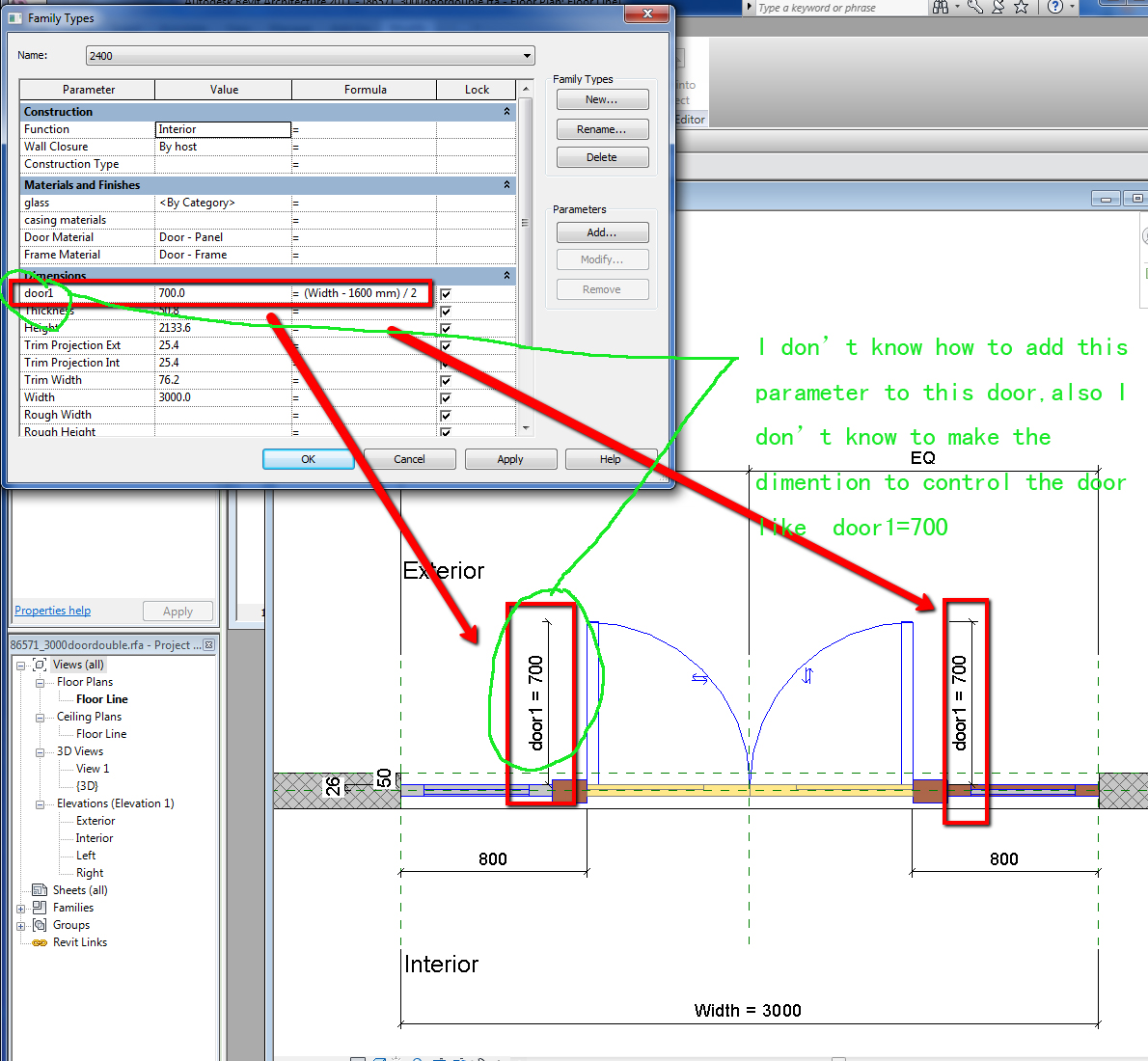

That door is wrong, create a parameter to control that "width" BUT when you are creating those model lines you must lock them (whole padlocks), delete them and do it again, about the sweep, create that in a 3D view and use the "Pick Path" tool and select both lines and the arc then drag those lines to the bottom of that door.
Tue, Dec 28, 2010 at 8:56:31 PM | but I don't know how to add that door parameters.
fairywiner
Joined: Thu, Oct 21, 2010
85 Posts
but I don't know how to add that door parameters. see as pictures I changed from your picture.

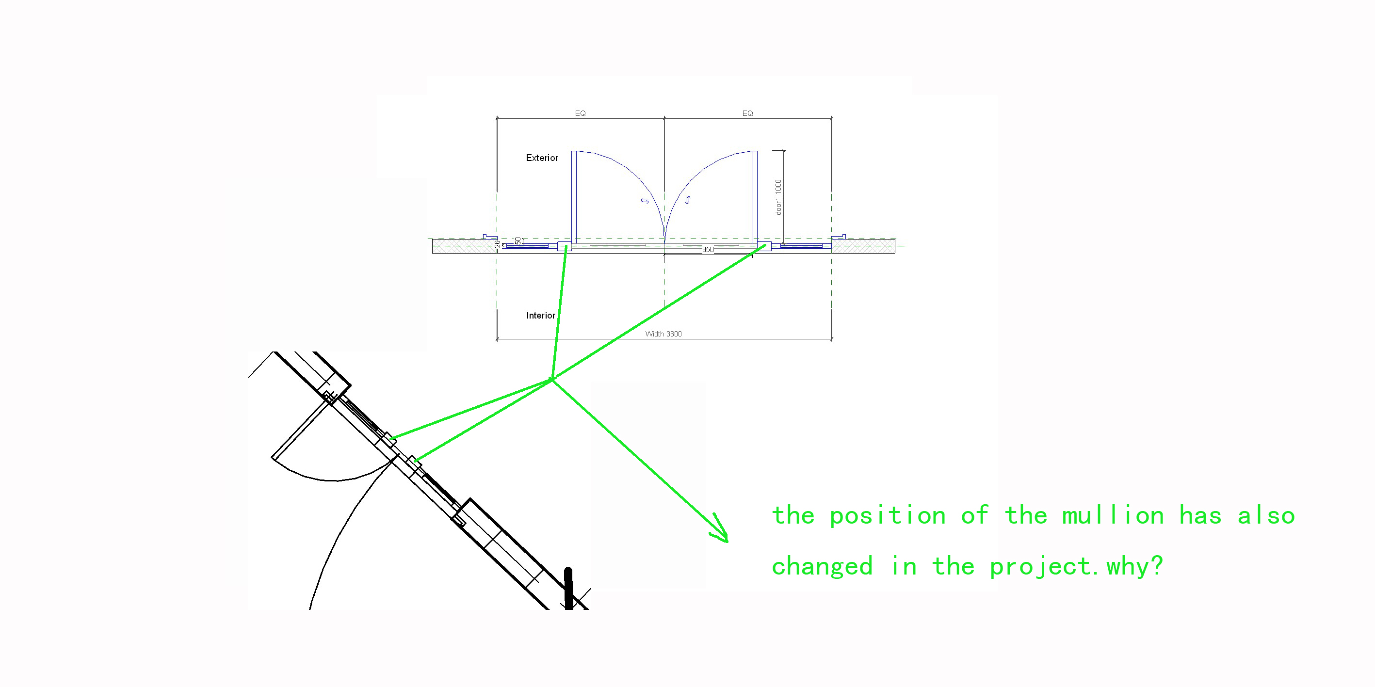

and why the mullion position change so much when the door family inserted into the family. see as picture5.

I'm somewhat sure that you do not know much about creating families, am I right? well, my advise is that you should first study the tutorials, here you have the link from Autodesk were you can download "Families_guide_tutorials", like you can see you have in "Chinese" too, http://usa.autodesk.com/adsk/servlet/item?siteID=123112&id=13376394
You can search in Youtube for free videos about creating families.
Watch this videos:
http://screencast.com/t/W5lbIvm4ll
http://screencast.com/t/Ihyq1juXX3j0
