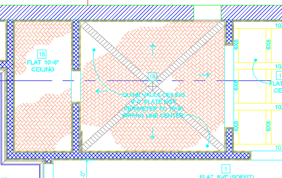

I'm modeling a house in Revit based on 2d plans.
The ceiling plans call for a "Quine Vault Ceiling" which I'm assuming would be like a Groin vault?
Any idea how to model this?

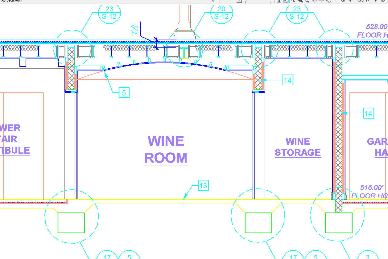

Here are the images that I have to go by to model this vault.
 I'm mostly interested in what Revit tool I should use to make a vaulted ceiling.

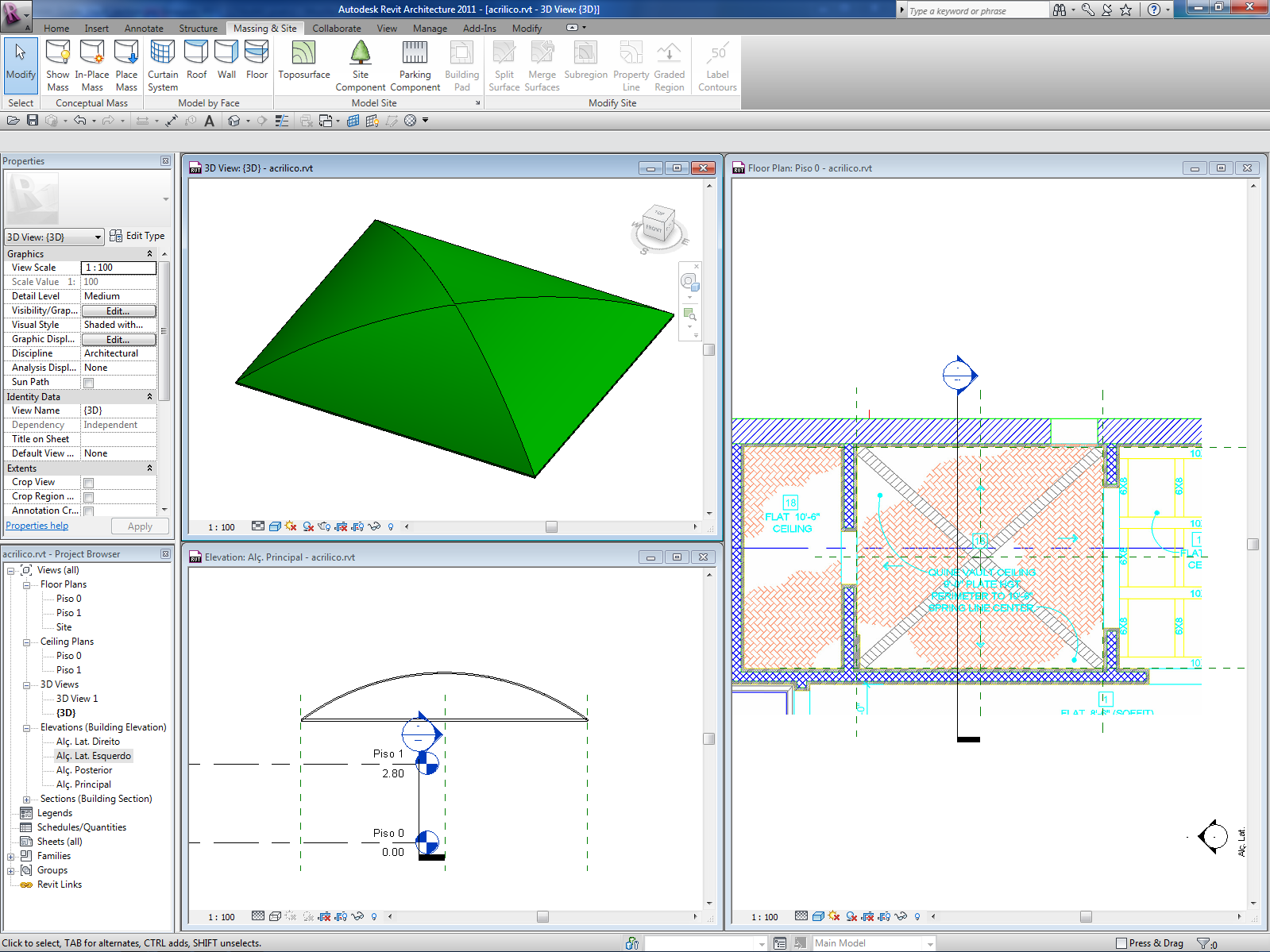

Something like this?
Simple, create a "Mass" and use two voids to cut that mass then apply roof by face, it's not in "Ceiling" category but solve your problem.

Thanks a lot, I got it to work that way.
My only problem now is that my roof only appears in 3D, not in 2D section, or plan - even though "roof" is checked on in my View Properties, so I can't figure it out.

if you modeled as mass object you must turn on mass in the VG
