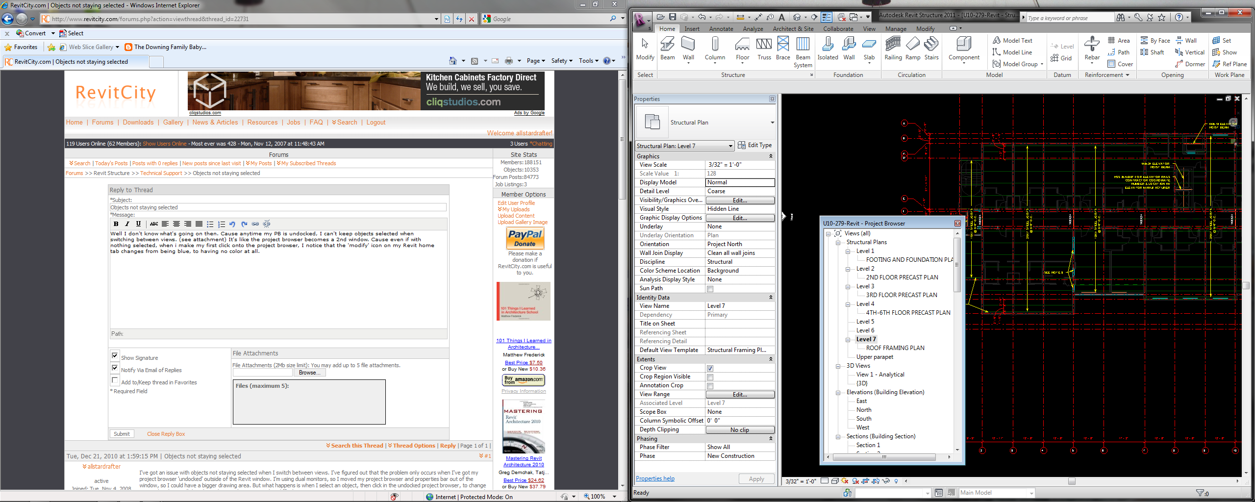

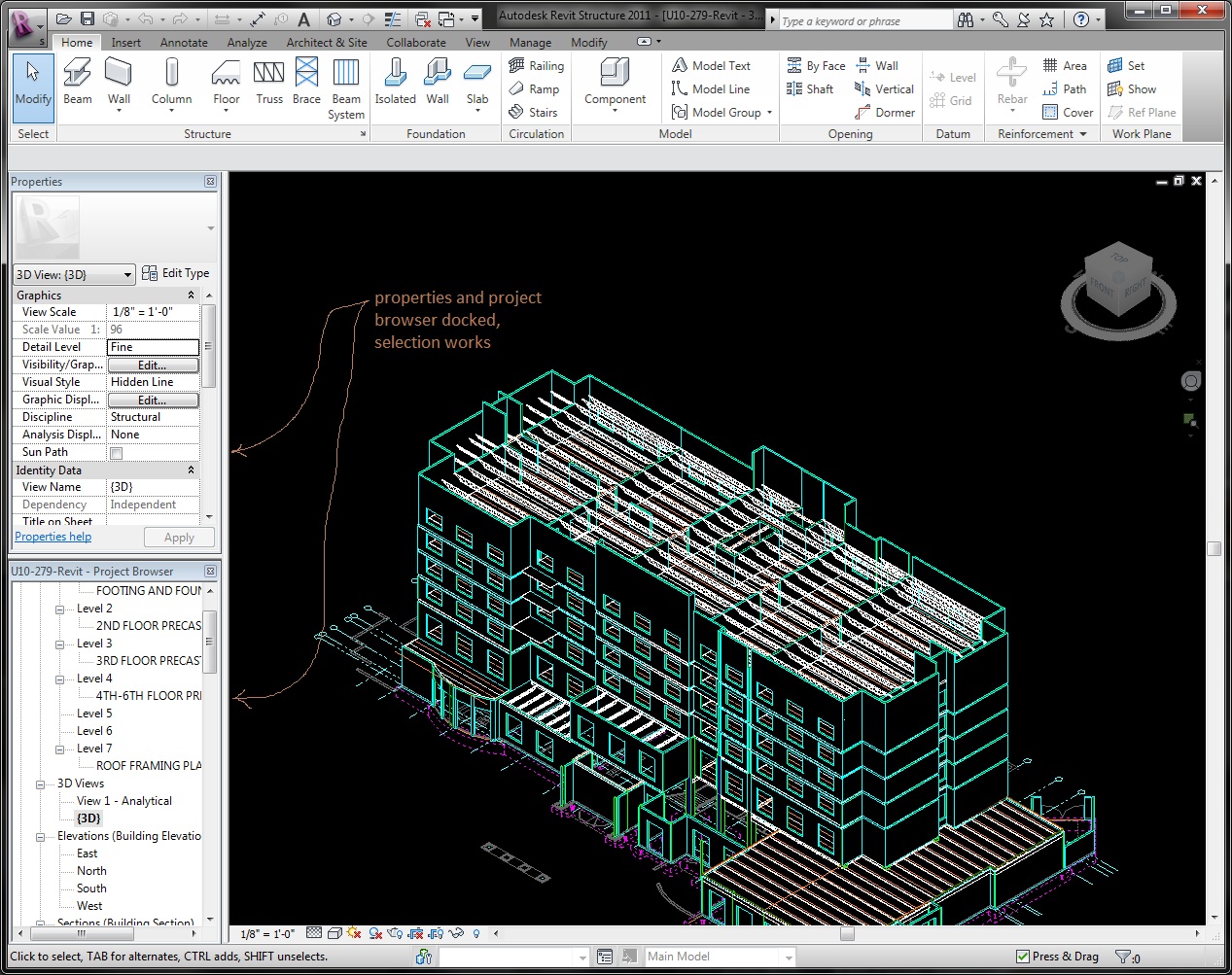

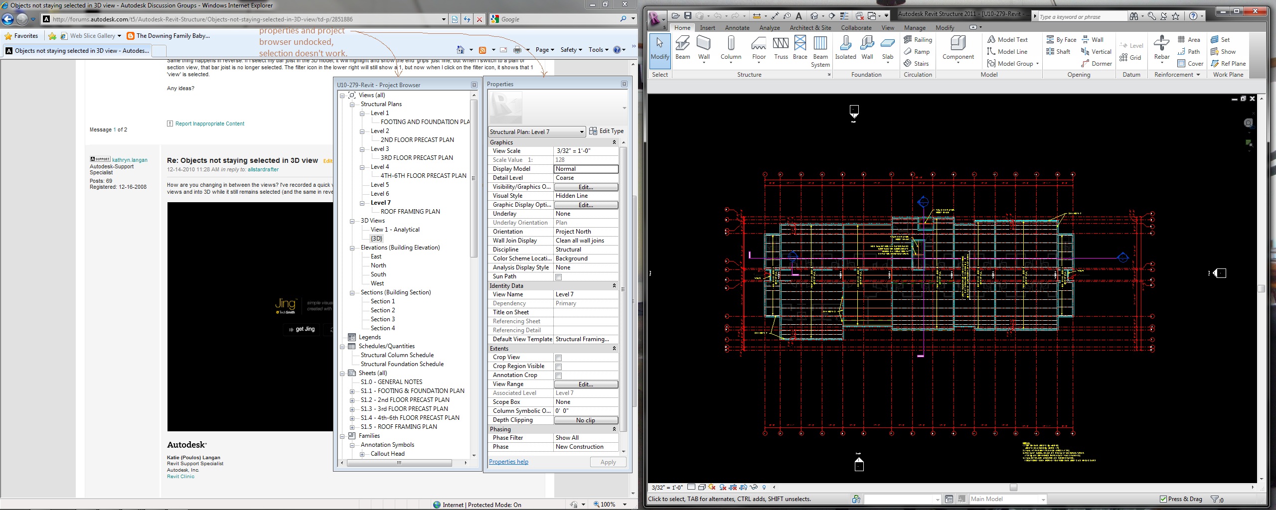

I've got an issue with objects not staying selected when I switch between views. I've figured out that the problem only occurs when I've got my project browser 'undocked' outside of the Revit window. I'm using dual monitors, so I moved my project browser and properties bar out of the window, so I could have a bigger drawing area. But what happens is when I select an object, then click in the undocked project browser, to change views, the object will de-select. This is making it somewhat difficult to manage my project, because I can't select objects in 3D and then move or edit them in plan or section views. See the attachments to better understand what I'm talking about.

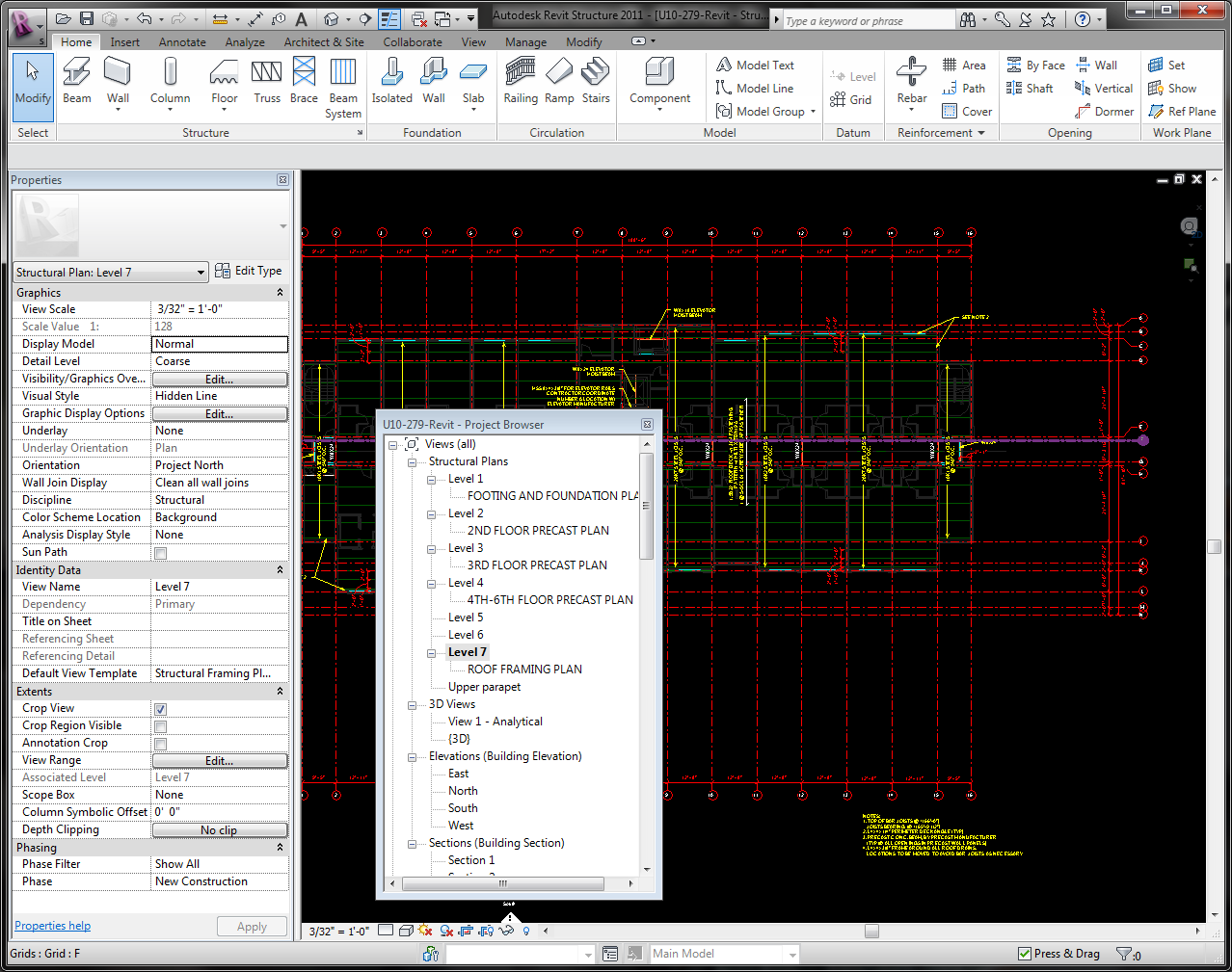

Well I don't know what's going on then. Cause anytime my PB is undocked, I can't keep objects selected when switching between views. (see attachment) It's like the project browser becomes a 2nd window. Cause even if with nothing selected, when i make my first click onto the project browser, I notice that the 'modify' icon on my Revit home tab changes from being blue, to having no color at all. Look at the two different attachments, one is when i'm clicked into the revit drawing window, and the other is when I'm clicked into the project browser. Notice the 'modify' icon, and the title bar of the PB.

My objects will de-select any time the PB is undocked from the Revit window. Does not matter if the views are open already, or unopened. But if I dock the PB into the Revit window, then everything works fine, between all views, open or unopened.
