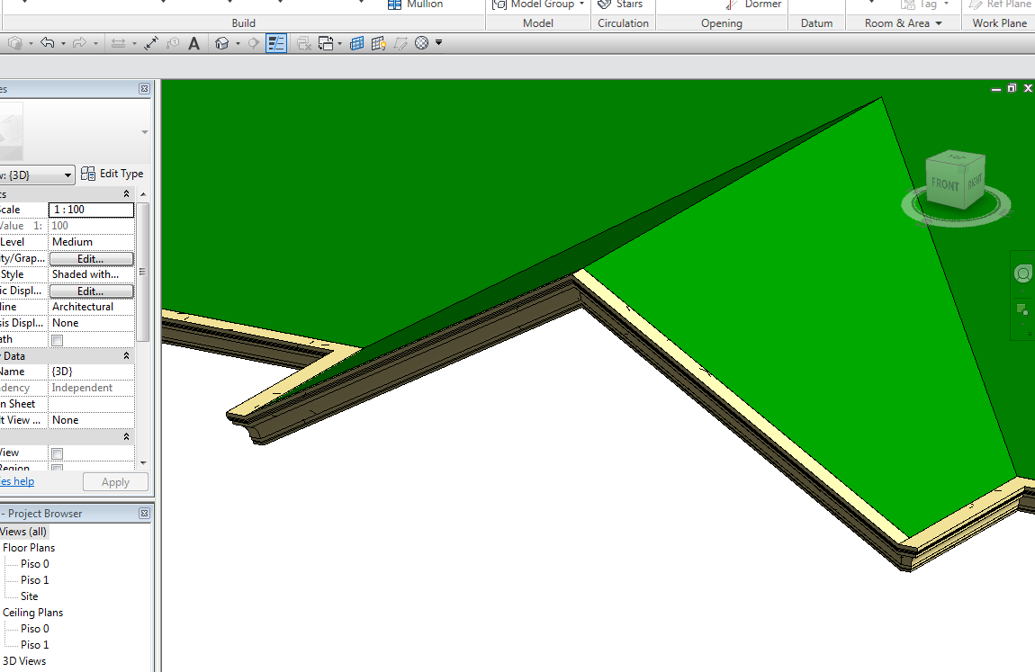

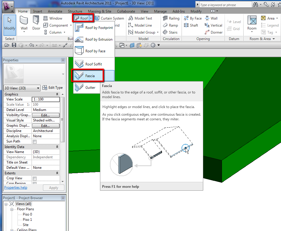

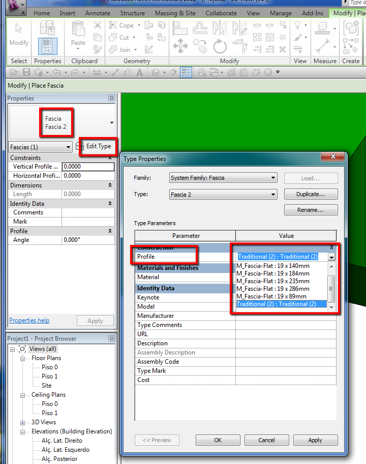

Create a family "Profile" with the shape you want, then in "Roof Fascia" duplicate it and select the new profile with the material you want, now just select the edges of that roof.
