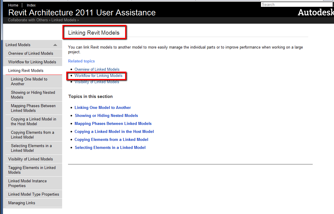

Hello,
I have four buildings and each one must start with different elevation (base floor). First I have drawn one block and then created other blocks by copy-paste method (I don't know different method). At this moment stopped because I have to give different elevation value for each block.  First block-basement start with 0, the other blocks              starts with 1.5 m
Please help me if anyone knows the solution.
 Thanks in advance.

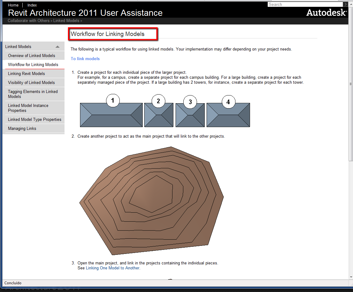

Look in your HELP menu how you can work with "Linking Models"
Sun, Dec 19, 2010 at 8:47:17 AM | Floor Elevation
Typhoon is right, If you have 4 seperate buildings, then you should consider 4 different models and link them together.
Or is this just a massing study?  You metion creating blocks.  Is that a mass or are you using an autocad term here?  If it is a mass, then you should consider seperate masses.  In place family extrusions are meant for single placement, not multiple.

Thank you very much.
I applied linked models to my project. It solved my problem.
