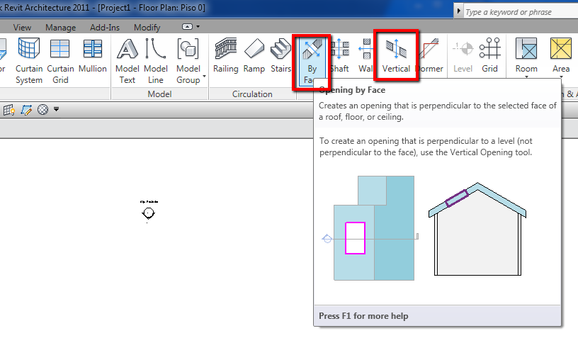

i'm trying to cut a void in my roof? wat tool should I use?
Tue, Dec 14, 2010 at 10:42:35 AM | ROOF VOIDS
Depends on the roof and what kind of void you need.
Flat roof - include the "void" in the roof sketch.
Sloping roof - does the void go perpindicular to the roof or the ground?
For perpindicular to the ground, I would do an in-place void family and cut the roof before I finsh the family.
For a void perpindicular to the sloping roof, I would use a face based void family.

Don't forget "By Face" and "Vertical Opening"
Tue, Dec 14, 2010 at 12:58:58 PM | ROOF VOIDS
Right typhoon .... but I don't like the openings commands.  They are very hard to adjust.
