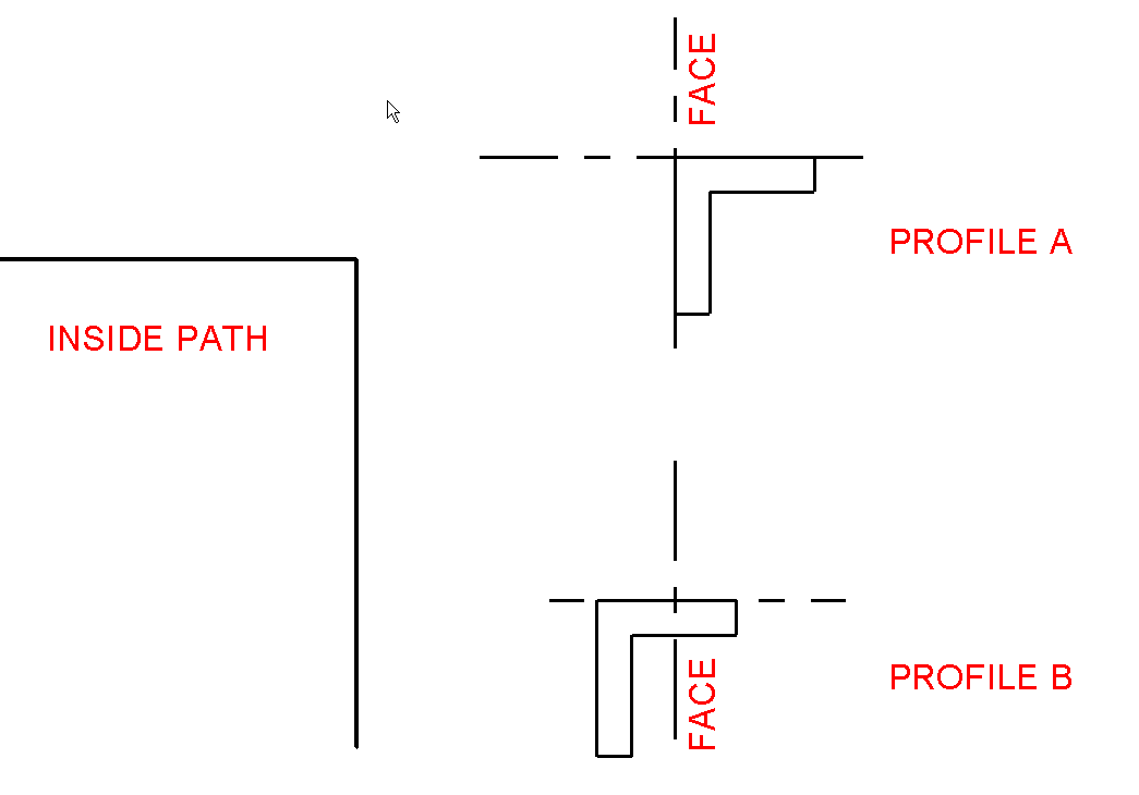

Im using Revit 2011 architecture. I have created a roof using the footprint tool. I have added fascia's to all straight roof eaves with no difficulty, however there is one part of the eaves that curves and i cannot get a fascia to fit this section. Has anyone any ideas?
Mon, Dec 13, 2010 at 9:21:59 AM | Adding fascia to curved roof.
A facia is a sweep and works the same.  If your profile is such that it can not successfully follow the path, it will not form.
I have found that if a profile has much definition in the y direction, the sweep profile should be completely "outside" the path it follows.  See attached.  Profile A will work, profile B will not
