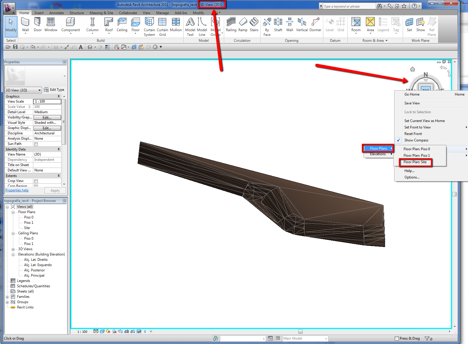

Hello all,
Is it possible to render a site in Revit Architecture 2010? I used to render the site in older versions but just can't seem to find the render site option in this version  Crying indeed there is one but I forget).
 Thank you

In a 3D view go to View cube > Orient to View > Floor plans > Site then you can render.
I think this is what are you talking about.

Thank you so much... you're a relief
