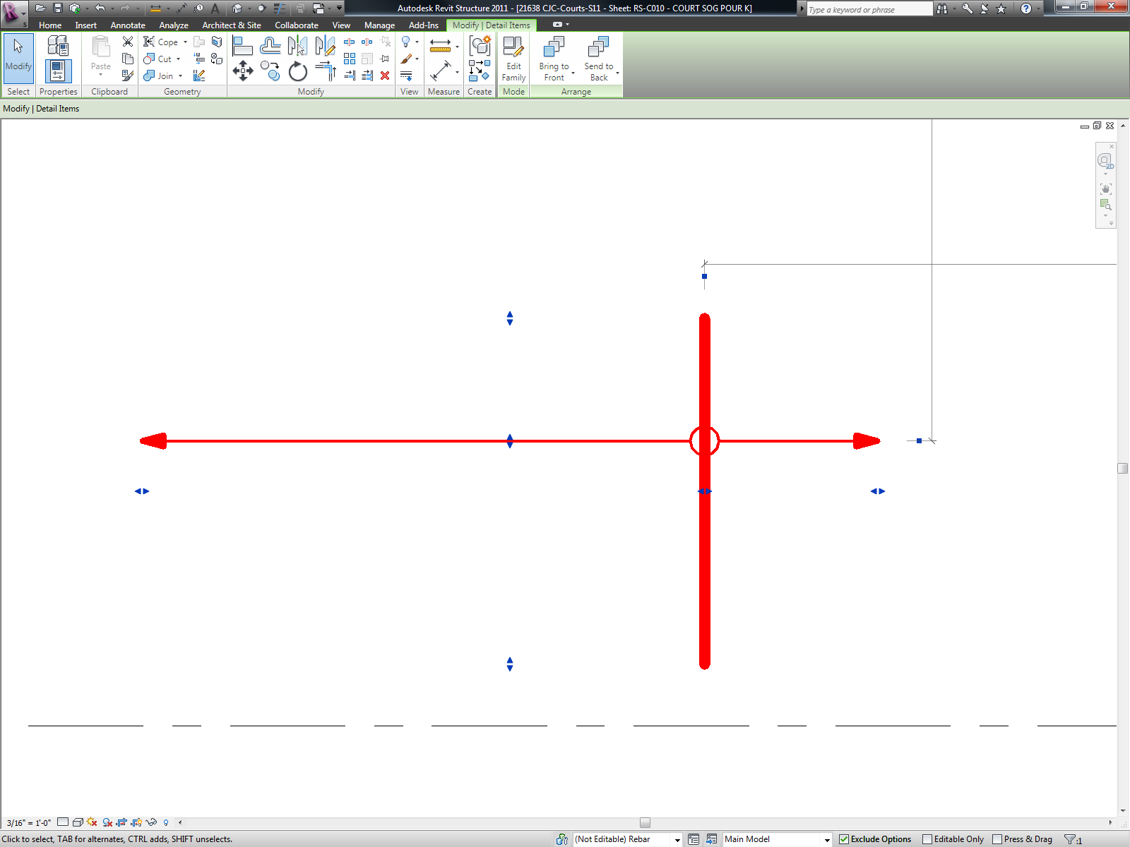

So I have an annotation that is two lines that make a t shape.  Right now I have been using reference planes to control the extents and all of the lines, but doing this makes the toggels go to the center of the family.  Is there a way, using reference lines or other, that I can keep the togels at the end of the lines?

My annotation is two lines that make a t I need to move i left and right and be able to extend it up and down, and reverse for -.  When I load the family into a project my togels to make the lines longer always are at the center of the family instead of at the end of the line.  See attached picture.  I want the toggles that extend the two lines to stay at the end of the lines rather than stay in the center of the family.

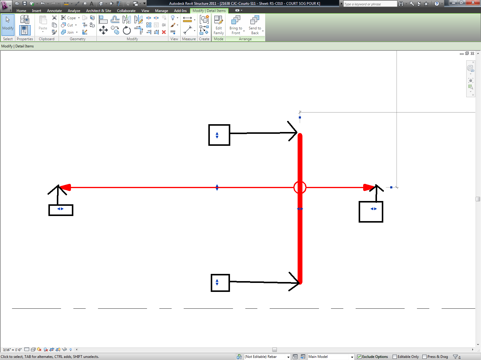

So the 4 toggels that I have boxes around control the lenght of the lines, but they float out in the middle of no where rather than being at the end of the line (in the project).  I want these lines to be at the end of the lines not in the middle of the family.

Tue, Dec 14, 2010 at 9:40:05 AM | Annotation
#10
Yes, I figured that because annotations don't have reference planes.
Those grips are always centered on the family in both directions.  I don't see any way to modify that.
