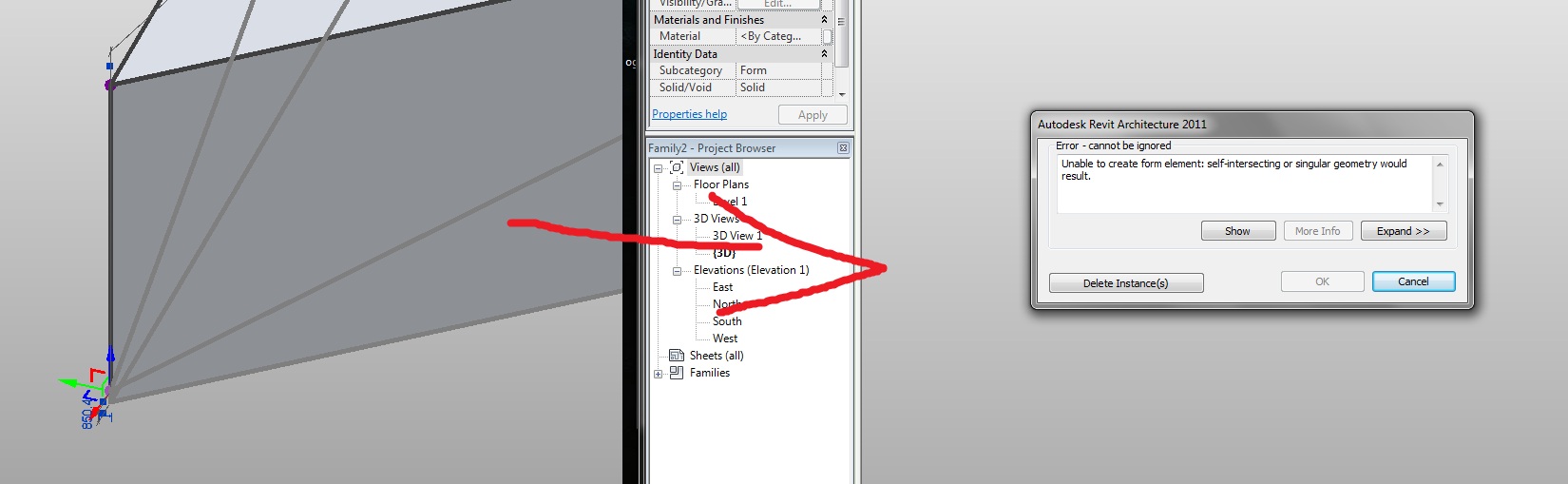

Hi I am trying to make a model of building like this (image 1) I know most of dimensions

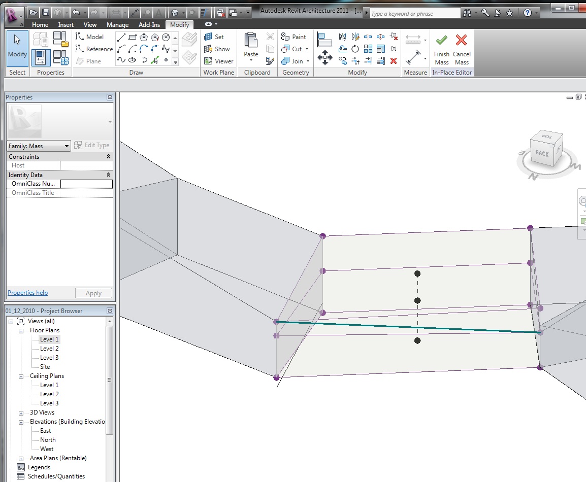

 I made a form for each segment but I have some problems (image 2)
for example with triangle- piece roof (mass doesnt allow edges on top)
and with this triangular wall (selected edge)
notice that walls are leaned basically in each axis -.-
I am stuck, how to do it?

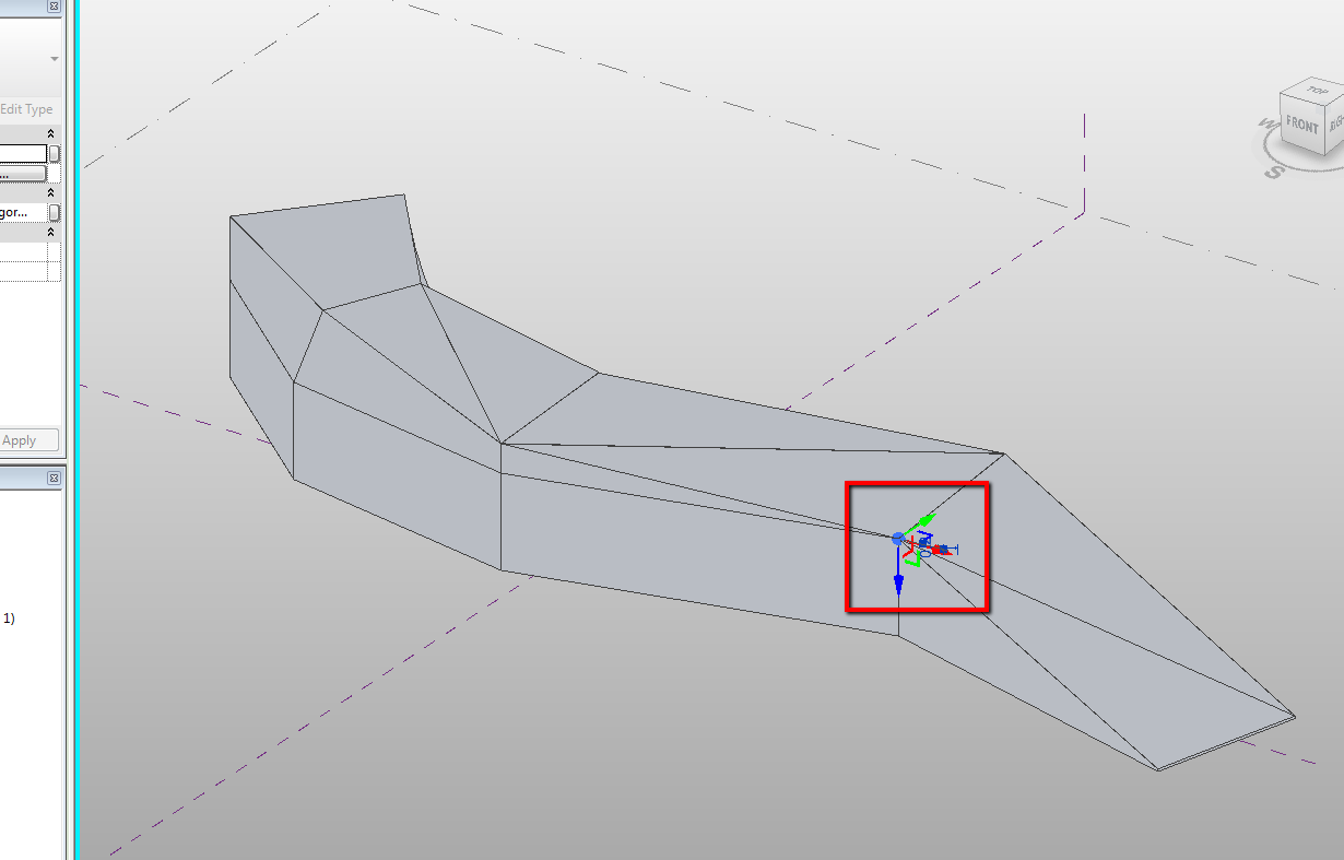

Do you know you can also manipulate the points? with your Spacebar you can toggle the axis (coordinates).

how did you make the edges on the roof?
Your model is exactly what I need.
Could you briefly describe how you did it?

Just create that separatly and adjust the "Points" like I told you before...

aaargh sorry :/ but:
it doesnt allow me to neither create form nor  move  vertex down to merge with lower one
I dont know how to make this form that is selected in your last picture
