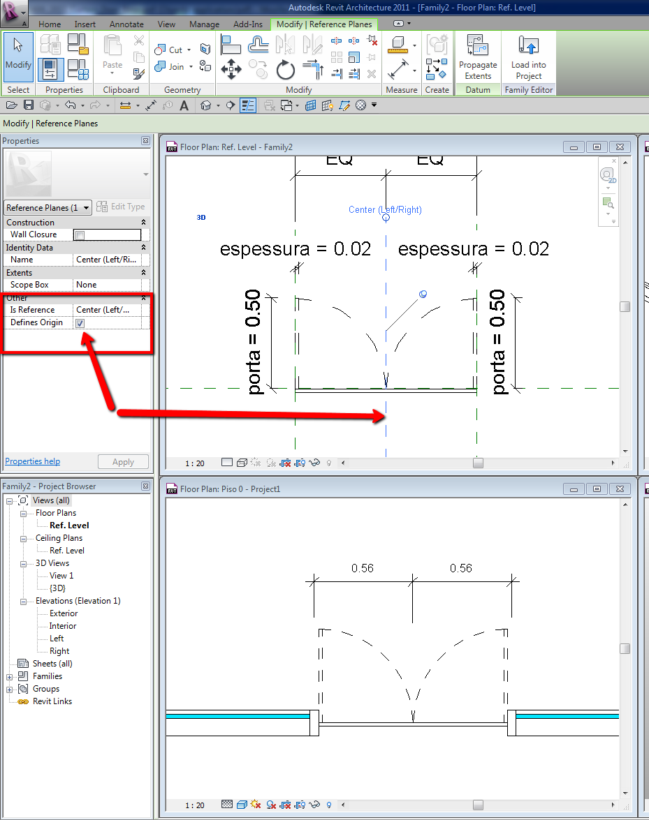

Turn the Ref. plane Center (left/right) the "Origin"

I just opened the 2011 template and it is correct.  The opening is centered and the ref plane defines the origin.  Someone may have changed your template so change it back.

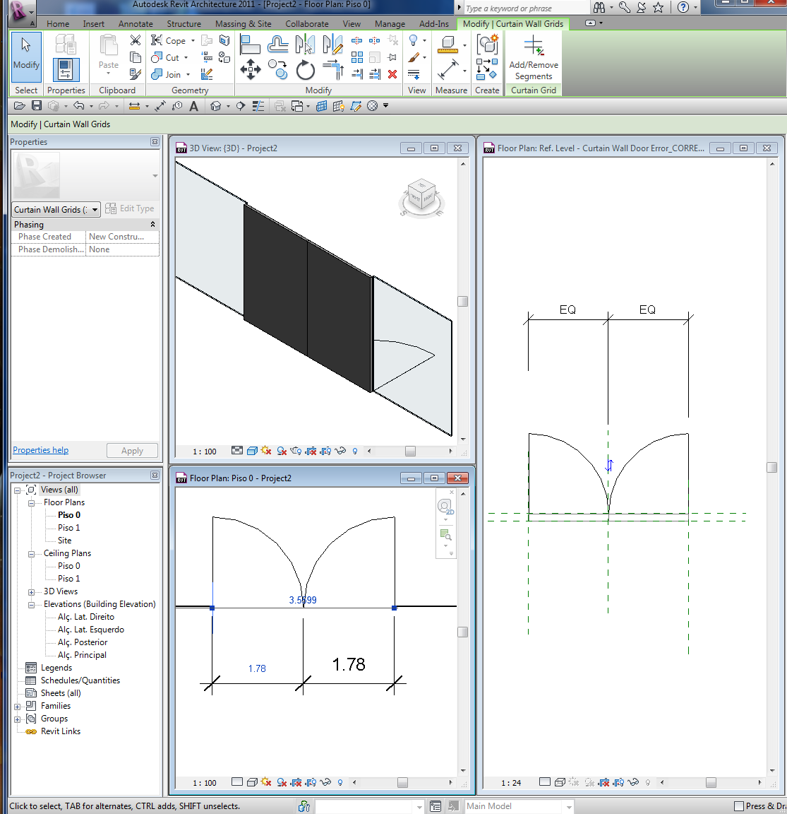

Ktam, i use 2011 US too, like you can see in my image it flex well in family and in PROJECT, can you put your family here so we can take a look when we can?

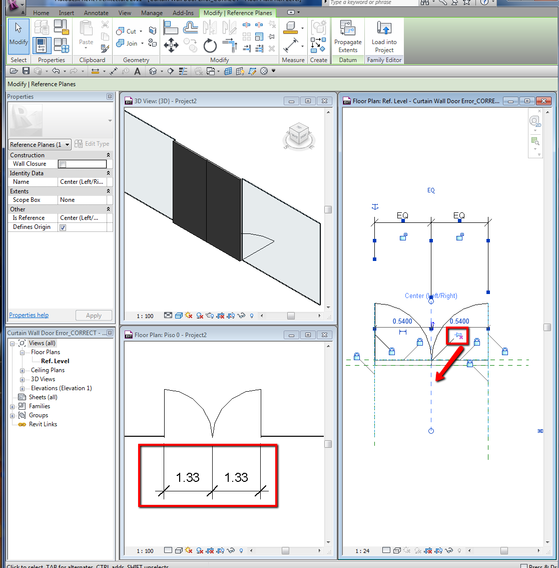

Here you have, i just deleted your model lines, create new ones and locked, and i change too the "Center (front/back)" ref. plane to "defines origin".

Just "Un-Pin" center (left/right) ref. plane, watch the video: http://screencast.com/t/2YfAKaXea5ga
