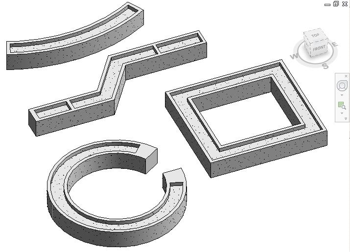

The link below goes to a 3 part video tutorial on how to create a 'Planter' type object with a basic wall family and an embedded reveal family.
First we have to create the reveal family profile then load it into the project.
