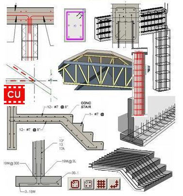

Are you trying to create a footing family or using the footing tool in the project?
REVIT Structure takes care of adding rebar to footings, slabs, columns etc without doing a manual array.
The attached image shows what was capable in REVIT Structure 2008.

dgcad - are you referring to the reinforcement extensions?
