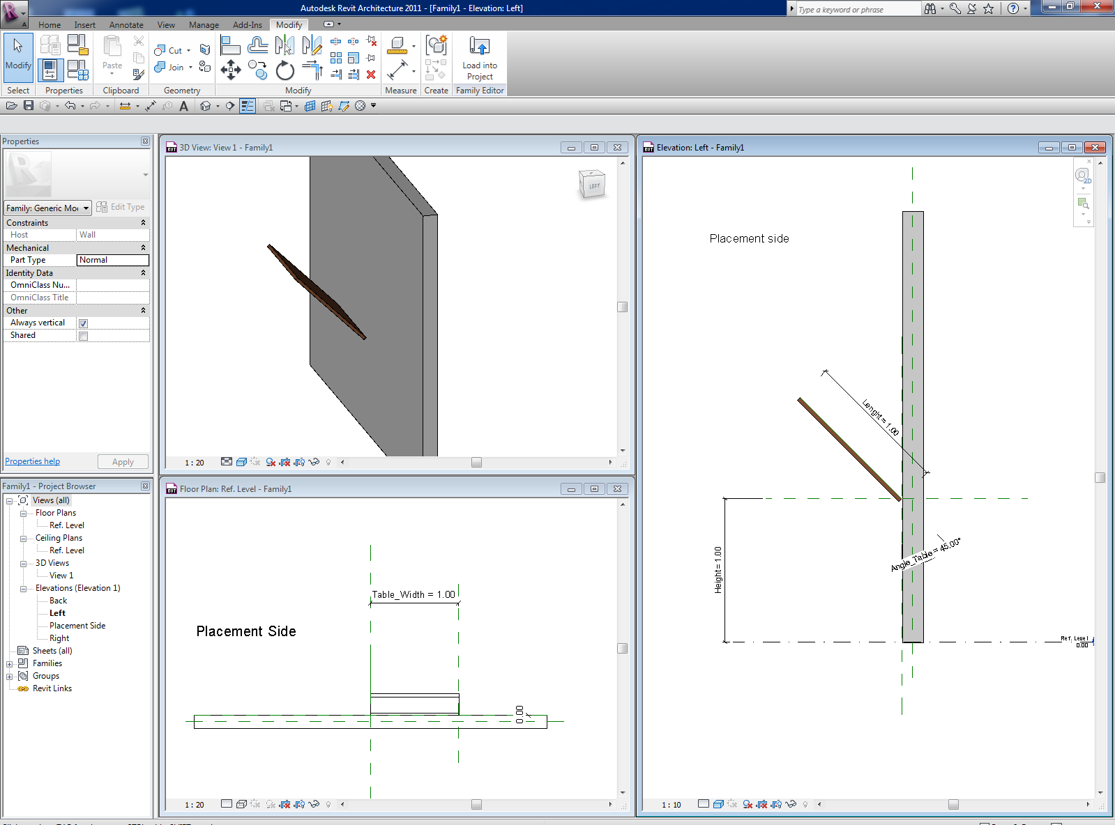

how do i make a foldable wooden table which is attatched 2 d wall on one side...such dat d wall is d host....nd d table can be opened when required for use...nd folded and closed when not in use????

Create a "Generic Model Wall Based" family with a Angle parameter to control that table, use a "Reference Line", i attached a simple family so you can figure out how you can create this kind of families.

hey thank you...the images dat u sent me helped a lot....nd i finally learnt how 2 make d table nd its come out xactly d way i wanted...thanks

I didn't attached the family, sorry, here you have.
