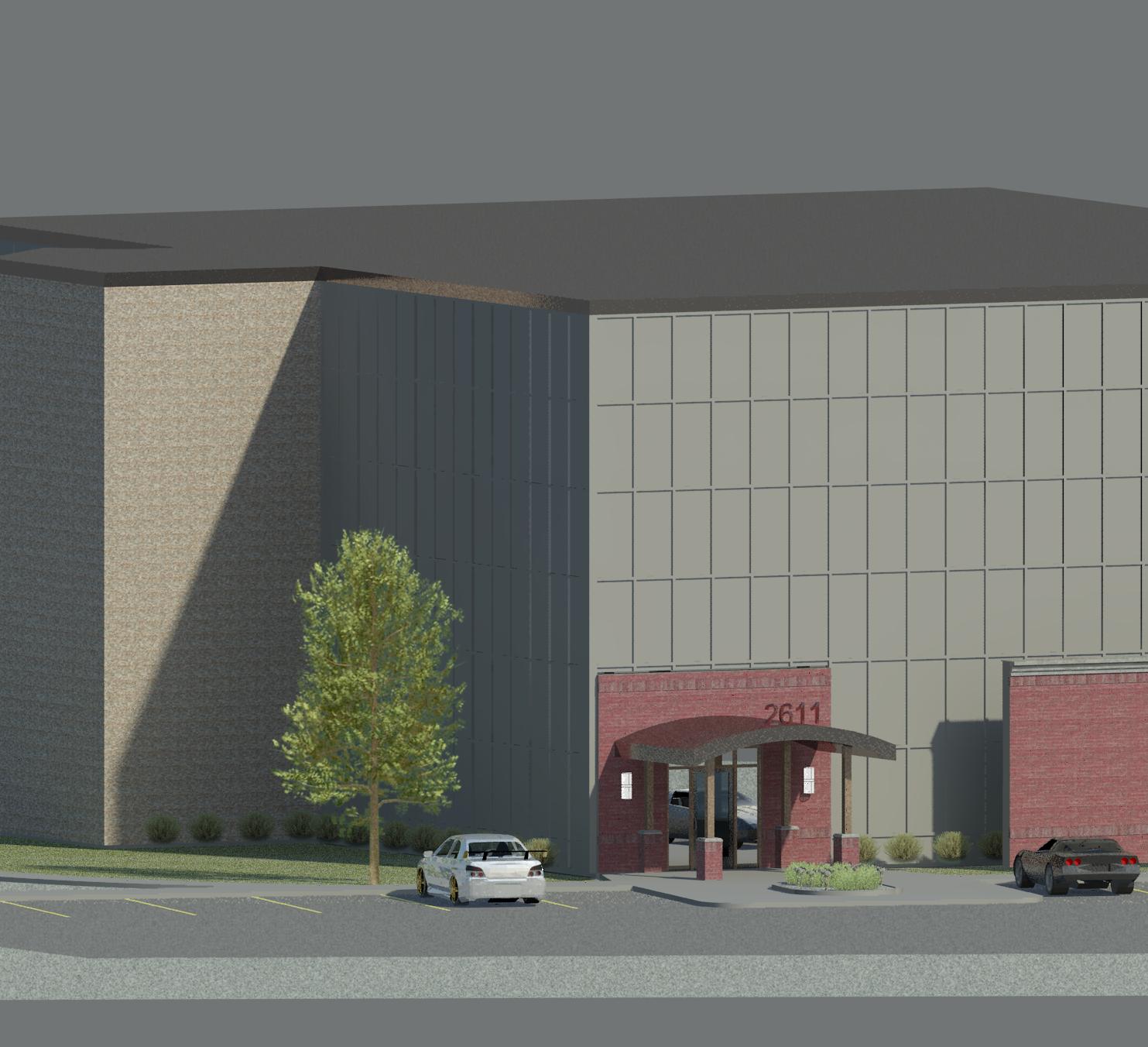

 Can I ask you one more thing?  I have the CW that is not rendering as reflective, but as gray.  What the heck? (see rendering)
Wed, Nov 24, 2010 at 1:50:23 PM | Sweep not showing up??
Either you have not assigned the correct material to your panels or your material itself is wrong.

I figured it out.....it was the phasing under view properties.  Needs to be set to "Show complete" on the rendering view.
