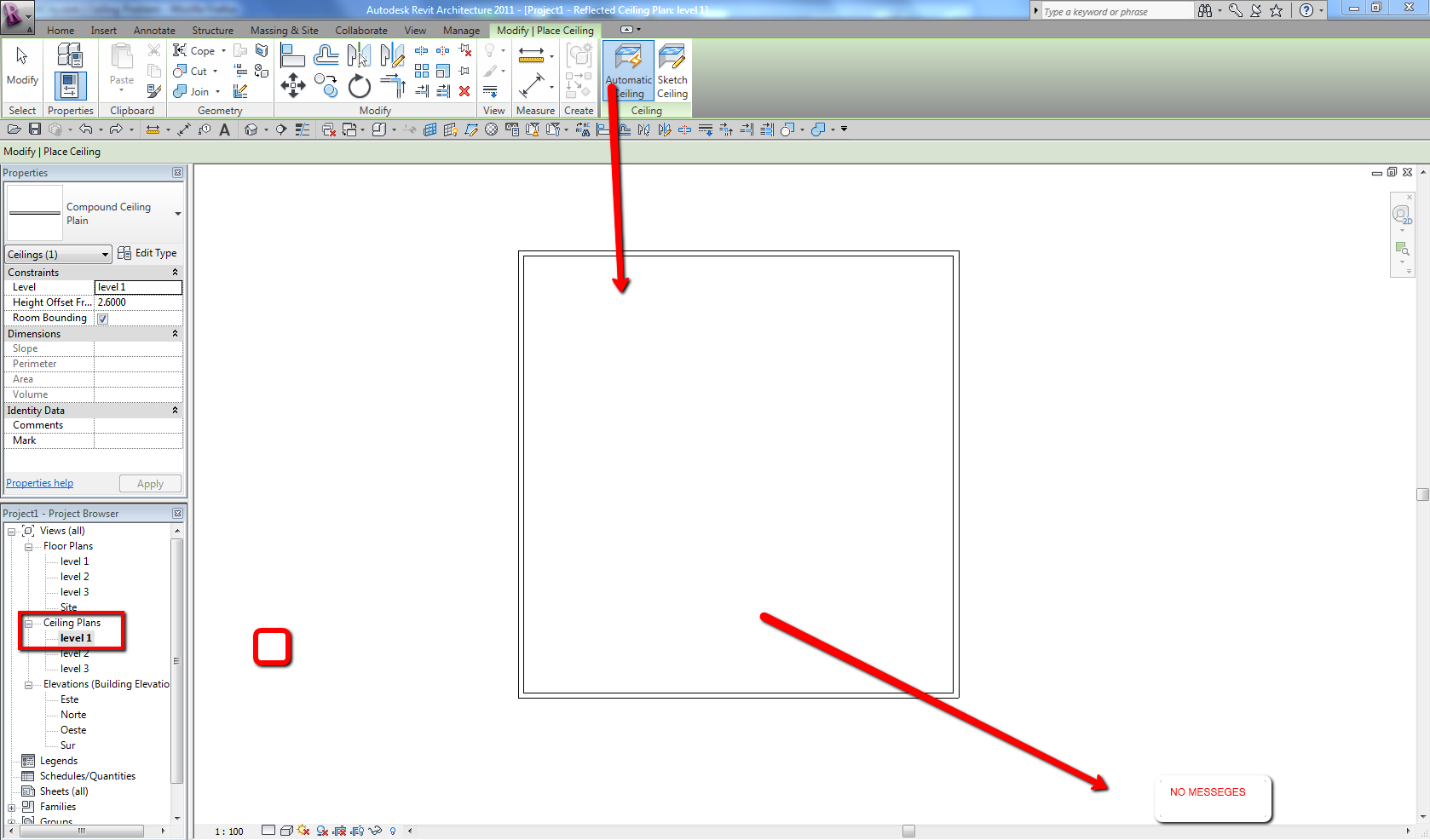

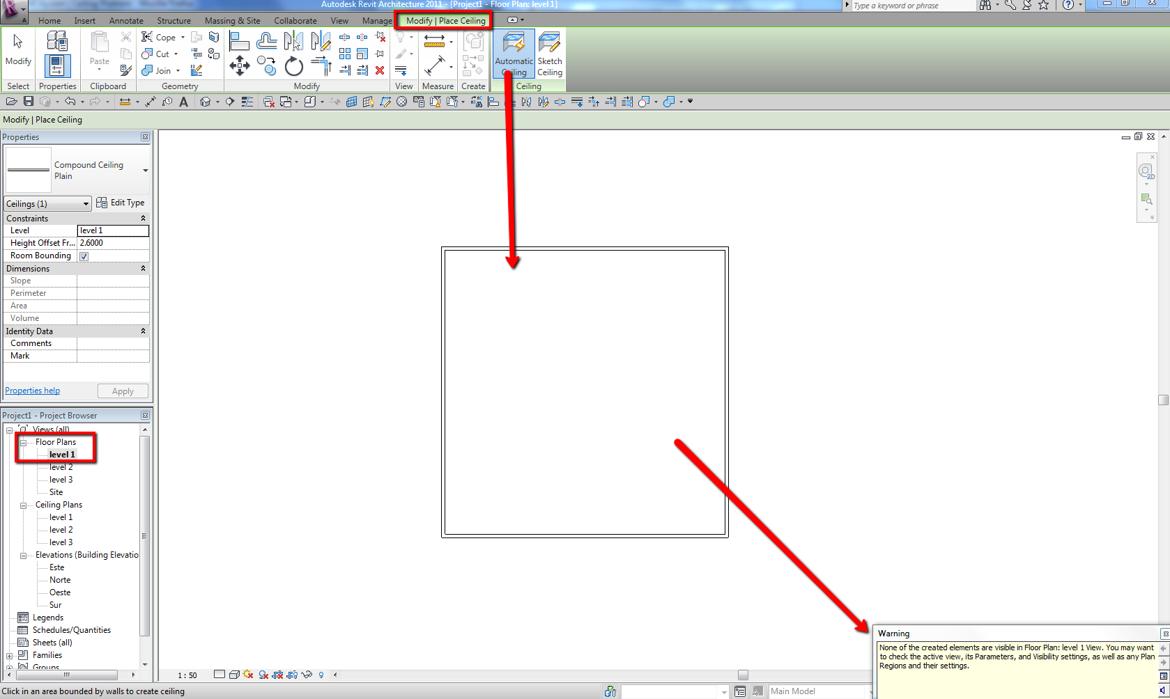

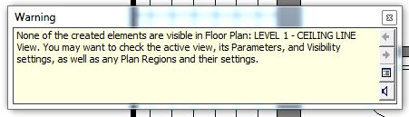

I'm trying to add a ceiling & lights, however I keep getting this message? How do I overcome it.
 Attached....

Because you are adding your ceiling in your floor plan instead in your ceiling plan. Create a section view and you'll see your ceiling...
