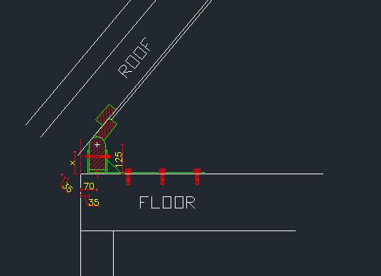

Hello,
I can't seem to find the right method to draw our roofs. We use prefab roofs, which come from a supplier that has its own demands for placing the roofparts.
In the attached image you can see our way of detailing this roof. (pre-Revit). Now the main problem is that the rotation point of the roof is 35mm outside the roof. There's no way I think Revit is prepared for this?
If we have a roof with all the same angles, the roof by footprint works OK, and i have created an excel sheet to calculate value "X" (in the attachement), so I can fill in the plate-offset. This is good.
But when I have a shielded roof, with different roof angles, I need different plate offsets, since value "X" is different for both angles. As you can see and imagine from the attachement.
Right now I'm creating a mass for this type of roof, but rather I'd use the roof-by-footprint function.
Could someone help me out (again)? Thanks in advance!

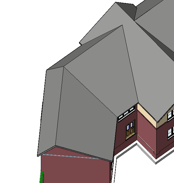

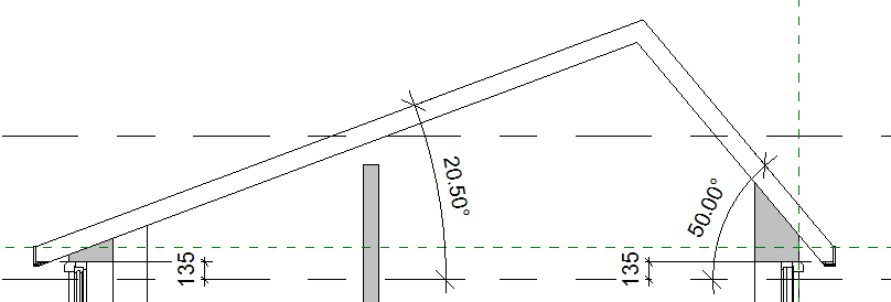

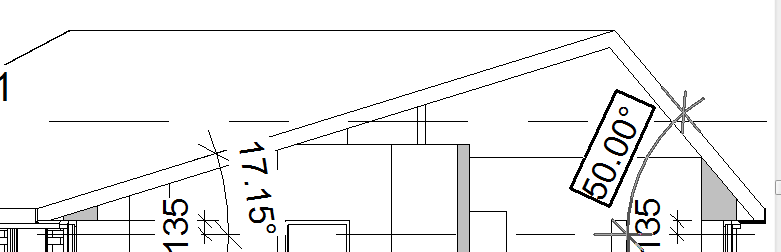

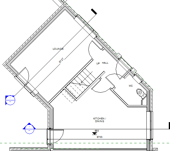

Plan showing differing widths
Sections through each with differing angles
3d
Soffit is at the same level throughout but due to different angles the offsets from roof base are different, but I had to do two differing roof's to get the final single roof to work

well, the Excel sheet is just to calculate that value. It's because of the roof's rotation point is 35mm outside the element.
I also tried to add an invisible layer to the roof, with a thickness of 35mm, so that the rotation point would be on the roof. This works, except I can't hide this help-layer. So I thougt to create a material with 100% transparancy, and that seemed to work, but this made the complete roof transparant, till the last layer.

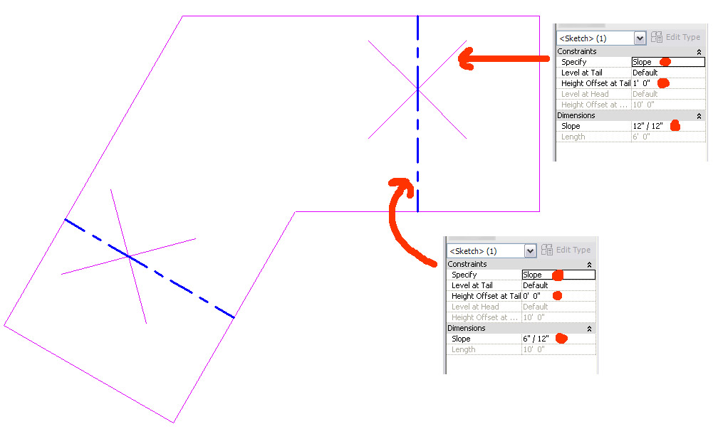

I think I may have a solution, if I understand the issue correctly.
Try playing around with using standard roof boundary lines and slope arrows to define where the ridge would be.  Set the slope to what each part should be.  Then set the 'Height Offset at Tail' (instance props of the slope arrow) to your 'X' value you calculated according to your first picture.  Do this for each slope arrow and you should have something you can play around with to work for your situation.

Hello Swiftimage,
 indeed, today I've been tweaking with these settings/options also. It seems to work!
Thanks for your efforts, and your time.
