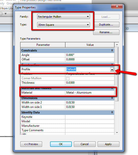

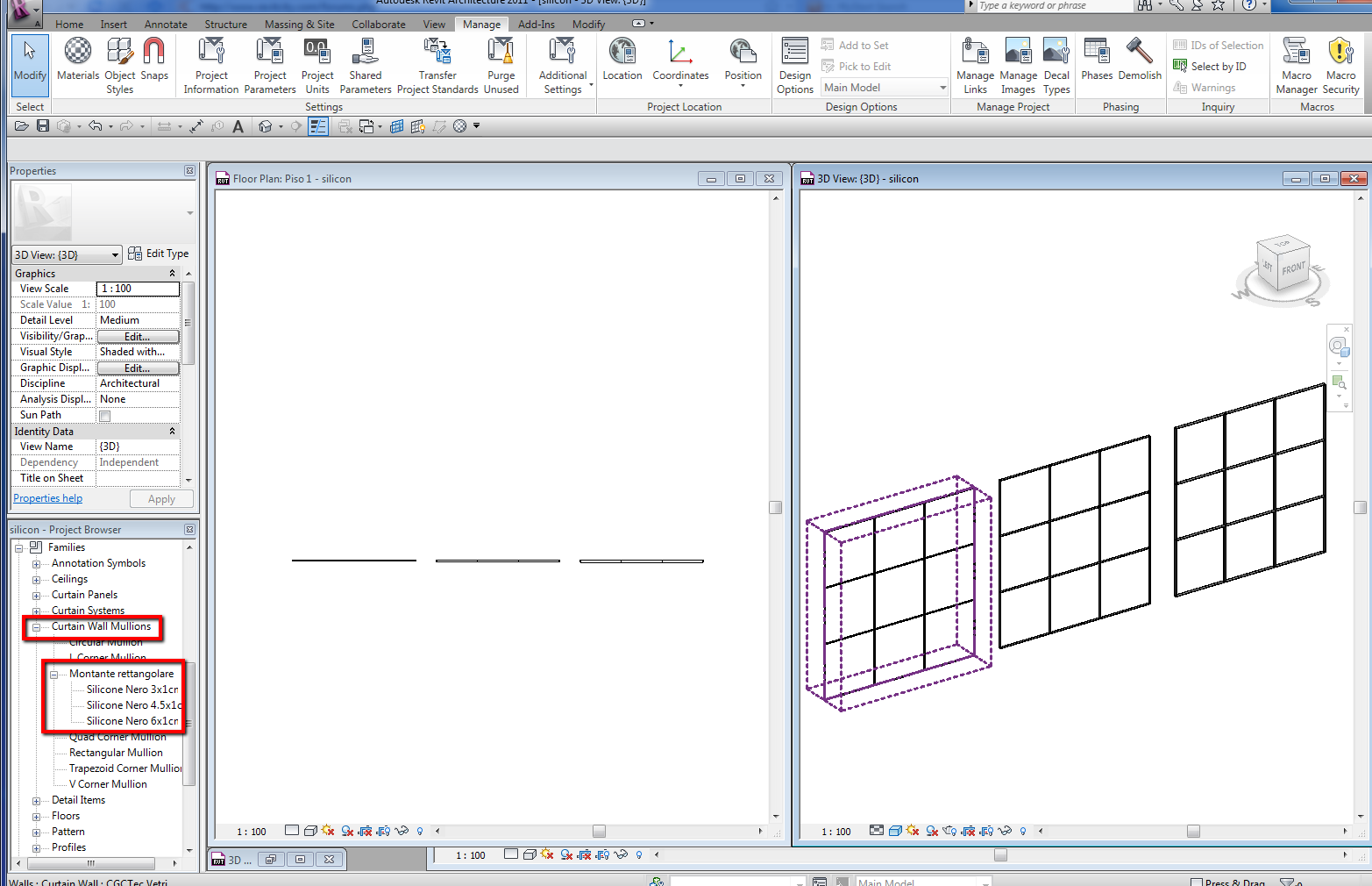

I'm trying to find out how to change my curtain wall mullion profile to be modified to show a silicone-glazed exterior joint.  In other words, I want to make a new family profile.  However, I am having problems finding the correct family to edit from.  I select my curtain wall, and the mullion options don't match the mullion profiles in the profile folder of the Imperial Library.
Sat, Nov 13, 2010 at 5:39:30 AM | curtain wall mullions
Joined: Tue, May 22, 2007
5921 Posts
4 Stars: 205 Votes

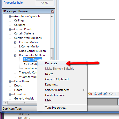

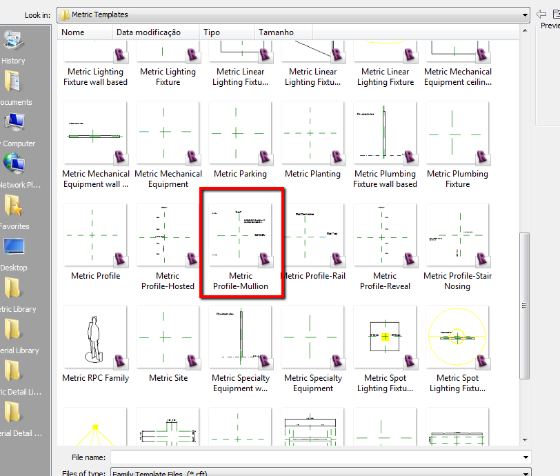

Here you have a file with 3 curtain walls with only the "Silicone joint", the name is in Italian but they are "Rectangular mullions", you can create a family profile-mullion with the shape you want then save and  load into the project, after this go to the project browser and expand "Curtain wall mullions" and expand "Rectangular mullion" and duplicate one of them, now open the new mullion and change the profile and the material you want, just look the images.
