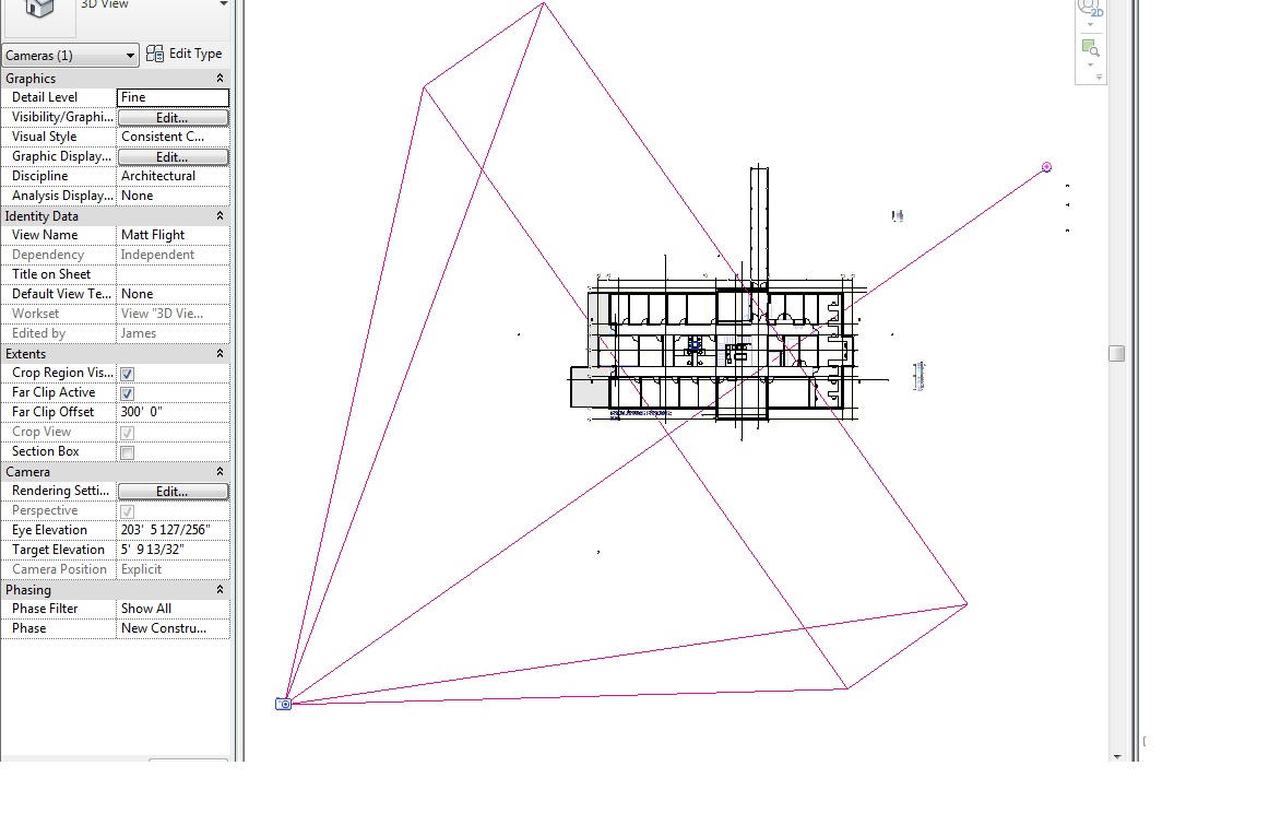

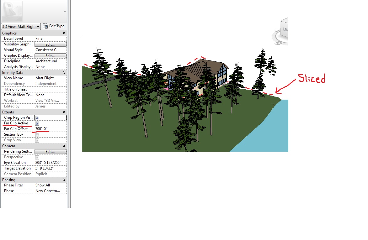

Hey--sorry I lost track of this.  I think your issue IS Far Clipping.   Here's an attached image of it in action.
also, if you select the border of your camera view, you can see your camera on the floorplan, and how far you've dragged the view to encompass.   You can drag this to be longer.  Think of the length of your camera to be your vanishing point.  The longer the camera is, the less extreme your perspective will be.  <-- SS #2
Hope this is what's going on and this helps.
