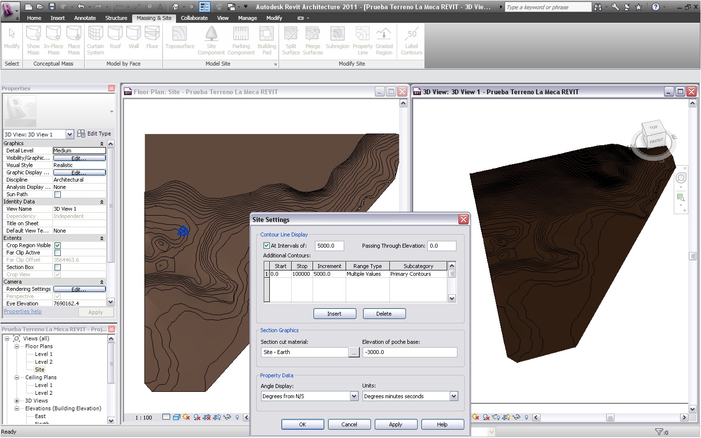

Hey there, i use revit 2011, and i have a problem with the toposurface function. I imported a dwg site plan into revit, with the procedure in revit's manual, but when it generates the toposurface selecting the instance, it doesn't pick all the points in the imported drawing, just  about 3/4 of the drawing. I was looking for a similar option as AutoCAD to make it select a bigger number of points but i just can't find something like that.

yeah yeah, sorry i made that mistake, i meant the points tha revit detect across the lines in the imported drawing.this site plan consists of 30 lines, with an elevation of 5 meters from each other. revit generates the toposurface but with just half the drawing, leaving like 10 or 15 lines.
Wed, Nov 3, 2010 at 3:36:38 PM | toposurface problem!!!
Now we have the correct question.  Revit is not missing half the lines. You have not told it what to show.
Under your "Massing & Site" tab, click on the down-arrow.  Here is the site settings where you tell it what interval contours to display and what subcategory they will be in in VG.  You can set primary and secondary contours which can give you two different line styles/weights.

hello again, thanks for your help...i followed your instructions, and as you said revit did generate the toposurface with all the information of the imported drawing, but i can't make it show all the lines of the surface in the site plan view. I add up an screenshot so you can see it. THANKS A LOT
Fri, Nov 5, 2010 at 7:40:03 AM | toposurface problem!!!
Sorry but your screen shots don't tell me anything.  Maybe you should look at the images you posted and tell us what we should be looking for.
The image on the right is just a dark brown area - don't know what is is supposed to be but the image on the left looks fine.
