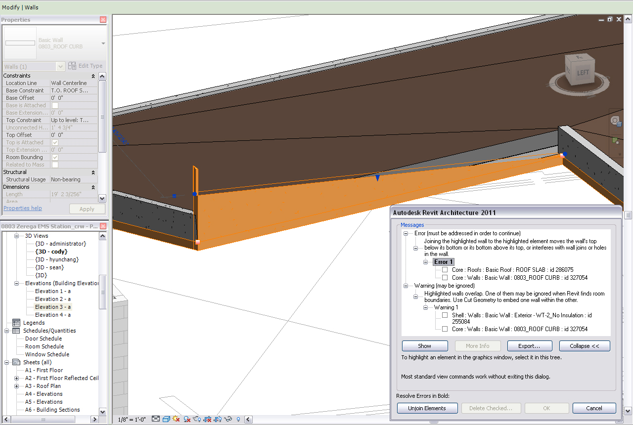

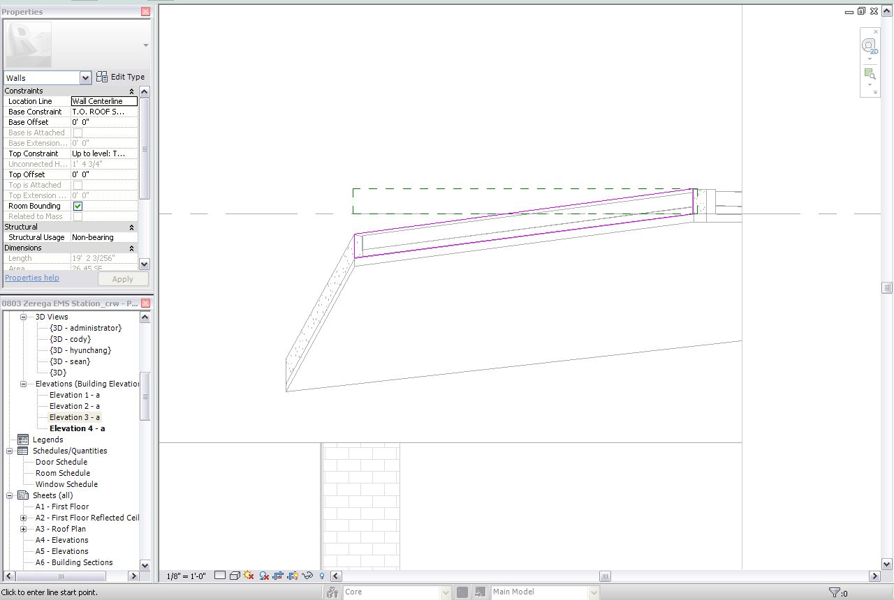

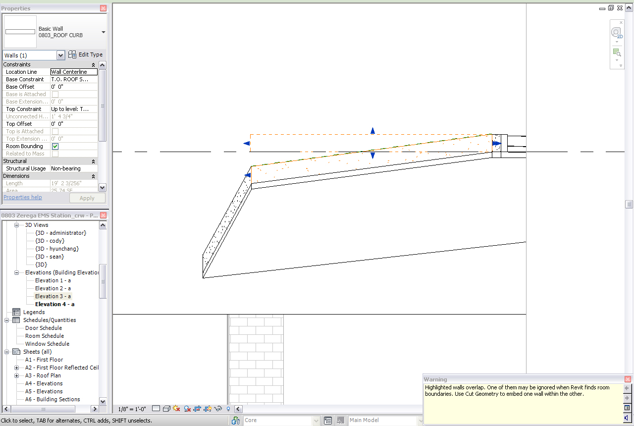

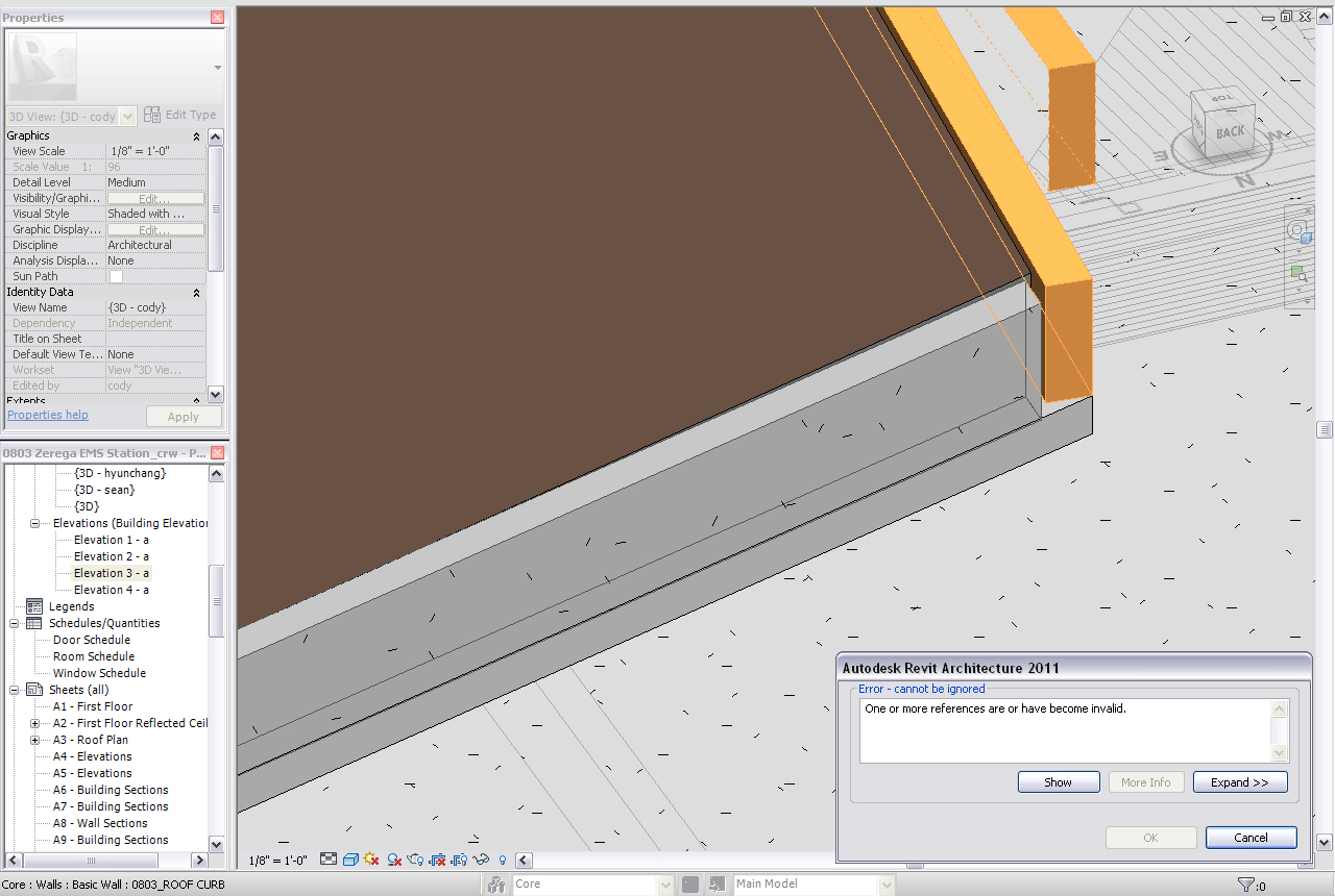

So I have been trying to work through some of the suggestions that you all have offered and attached are some of the issues that I'm having:
-Attaching the bottom of the wall to my sloping roof has a problem that I'm not sure what to do about, plus my name reference plane for the top does not show as an option in my properties dialogue.
-If I edit the profile I get the desired slope, with warnings, but I can't join to adjacent walls.
-The best luck that I have had has been with the in-place families created as a wall, but alas, I have no options to add to the structure or to create a coping profile. I would have the same functionality with imported rhino geometry.

if you have a very specific form, and it doesnt repeat too much you can use a model in place (place component/model in place)
There you assign a category, probably roofs or sumthin, then model your specific needs. You can use simple extrusion.

That's what I did for the rest of the parapet. It works okay, it's just limited by the amount of reference planes you have to use in order for all the slopes to cleanup with eachother. I was hoping to have a coping profile attache to them, but I can't do this with inplace familes? Or I guess I would have to use sweeps within the family?

I don't understand either. It has a problem attaching to my roof, that's what I was trying to show in those images. As far as I can tell, all of the objects and constraints are modeled and set up properly; roof modeled as a roof, wall drawn on view associated with a level corressponding to the top of the roof, etc. It has a problem with the slope or something (it does slope in two directions in some instances). I want to keep it a wall so I can easily attached my coping profile without excerbating the problem with in-place family sweeps ontop of extruded masses and such.

If your roof is warped (sub-points edited), then that may be a problem.  I would have to check that out.  But if the deck is flat and slopes in two directions, that should not be a problem.
In order to attach the bottom of the wall to the roof, the roof has to be under the wall and the wall may have to physically start above the roof.

It turns out I can't attach any of my curbs to the roof let alone the ones I want to slope. I'm attaching a copy of my file if anyone wants to see whats wrong. It's 2011.
