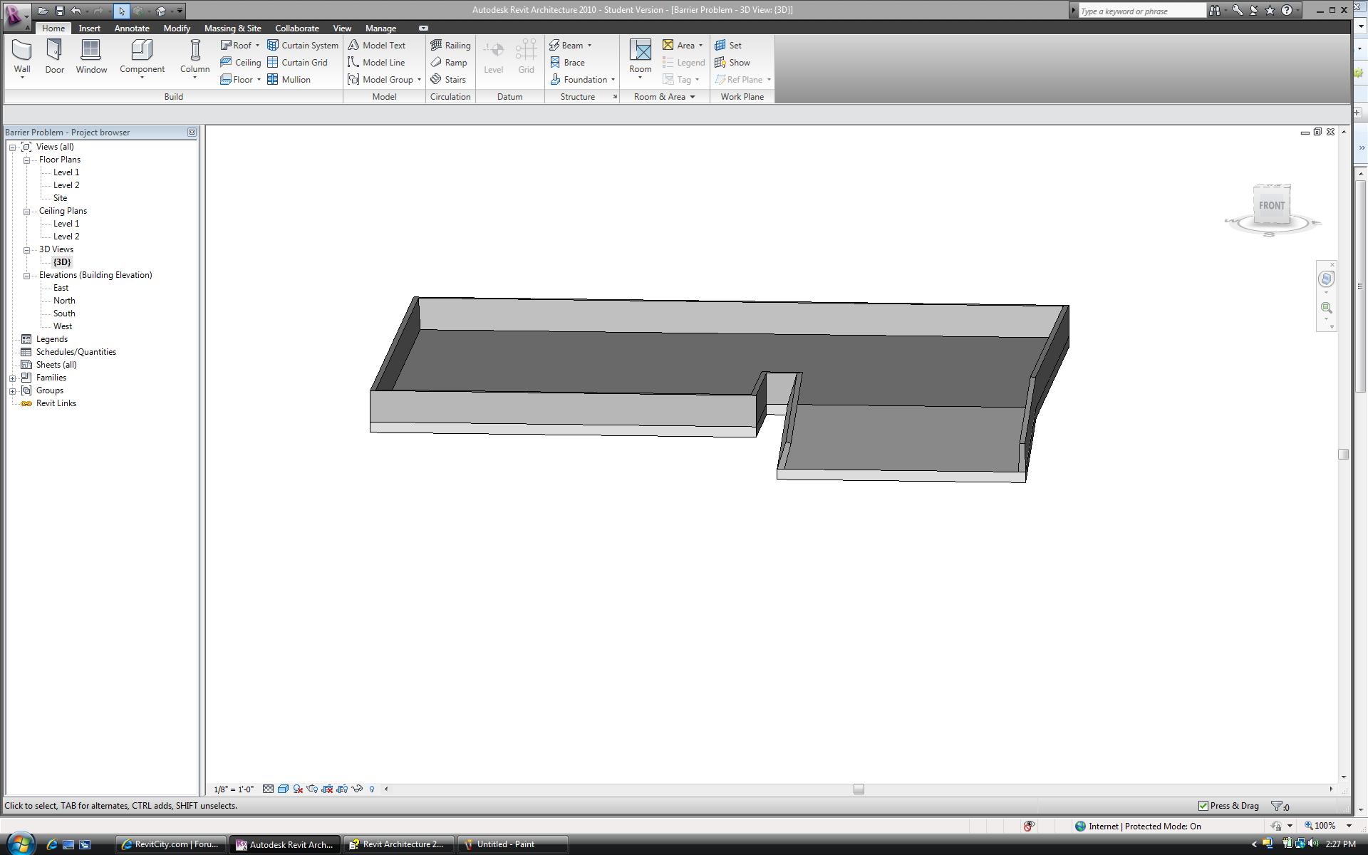

Hello all;
I am trying to draw a multilevel parking structure for a class project in Revit Architecture 2010. I have the floors done with the ramps utilizing the modify sub elements tool with no problem. I need to draw a barrier around the edges of the floor including the sloped ramp. I think I need to create a family but I have little experience with that and my instructor ?? is clueless. Could someone recommend a tutorial on the subject or point me in the right direction. I want to learn but not getting much help in class.

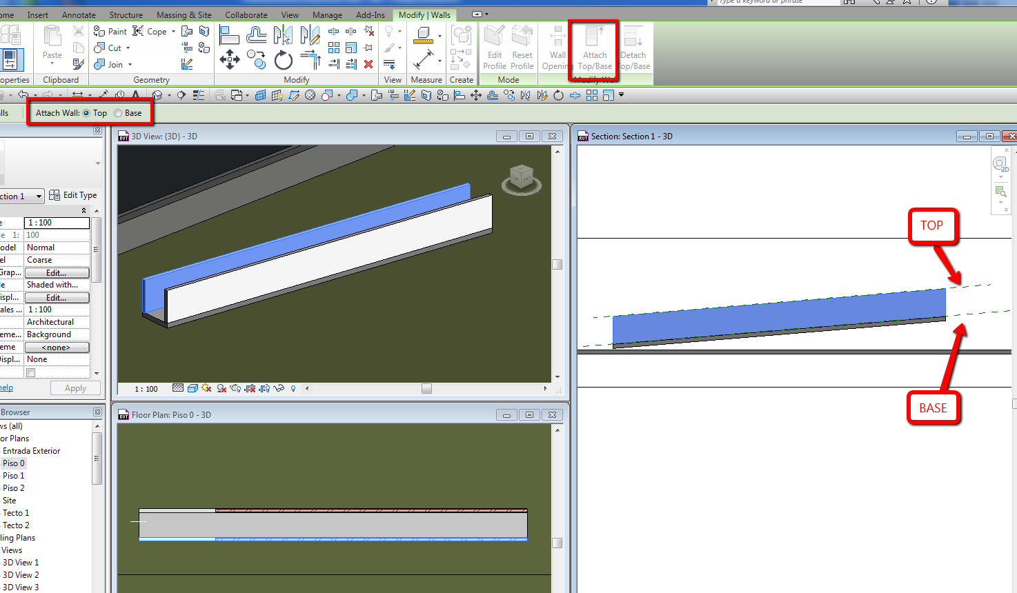

A simple way is: use a couple of "Ref. planes" and attach your walls (Top/Base) to those ref. planes

Hello Again
I've pretty much solved my problem by modeling in place, solid, sweep as seen in the enclosed project. Just one thing is wrong. The sweep work perfectly except for the left side of the ramp (note: this is just rough example of what I'm trying to do). For the life of me I can't get that section to line up with the rest of the barriers orientation. Any thoughts or suggestions would be appreciated

Why do you create that with a Solid Sweep when you can create that with only walls? For those "Sloped" walls, in a Elevation/section view you can edit those walls and draw the shape of that like you want.

Watch this: http://screencast.com/t/mKV2XvwO6M8B
