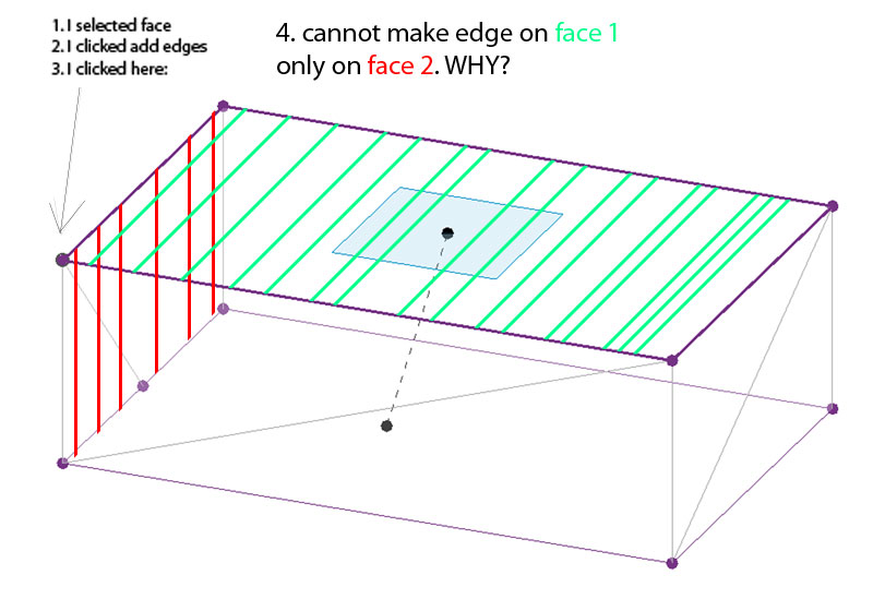

1. attachment. cannot figure this out, I guess work planes have nothing to do with edge creation.

create the extrusion from an elevation view... click on set ( in work plane set) and click on a elevation plane ( use mass family for that) BUT the family will be elevation based hosted. one problem creates other >_<.
So... i try something and it works. Click create new mass family, there create a line on workplane horizontal. Click on the line and create a form from it ( it will create a plane)
On that plane set the work plane ( its now an elevation plane) from there start your shape ( use a box orkinde) add some edges, and finally click on the original plane where you hosted your form, and click on "dissolve. That will shrink all shape changes from the plane. Hope it helps
