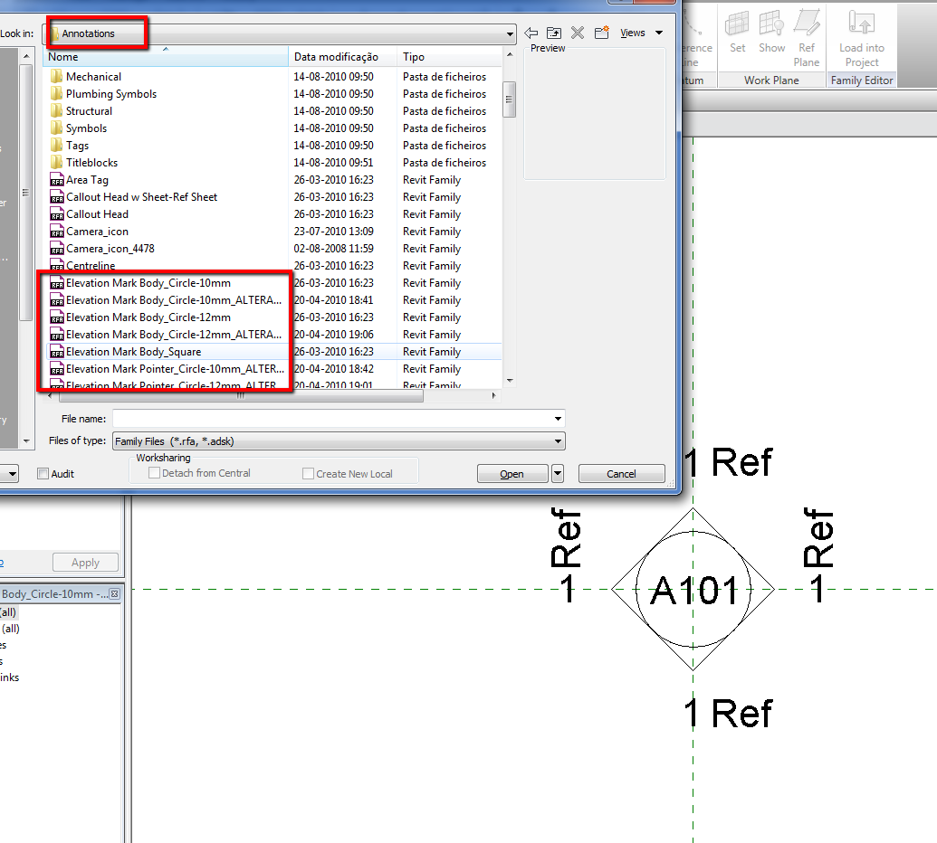

The internal Elevation markers in Revit are ridiculously big! Has anyone figured out how we can make the circle smaller than 10mm yet? Thanks

You can create / change your elevation mark size like you want, check the image...

Out of interest, I notice behind the options box in your snapshot you have the elevation marker open for editing. How did you do that? If I could do that it would be wonderful.
