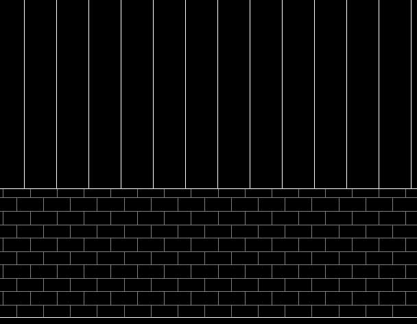

I need work with a wall that contains 2 textures. I have attached a picture. How do I do that?

You can use a "Stacked wall" or you can use the "split face" tool and divide that face in two, then use the "Paint" tool and apply two materials to that wall.
Mon, Oct 25, 2010 at 5:16:04 AM | Wall Issue
gebber
gebber Avatar
Joined: Thu, Jan 24, 2008
144 Posts
5 Stars: 4 Votes
The problem with the split wal is it doesn't show right in the section.
An other way is to draw the 2 walltypes on top of each other.
Anyway using the stacked wall is better.
