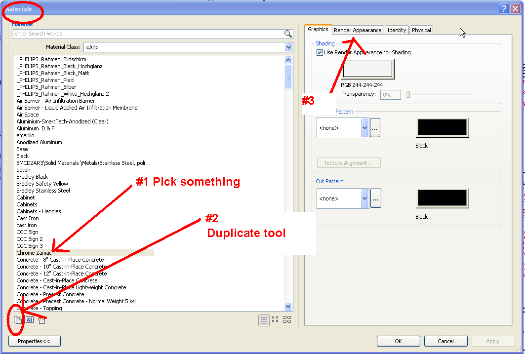

Mon, Oct 25, 2010 at 7:26:05 AM | Paint Help
Yes, duplicate is available:  Look at the attached.

DERRICK88ROSE
Joined: Wed, Sep 8, 2010
7 Posts
5 Stars: 1 Votes
Thanks WWHub, that diagram helped a bunch.  I was trying to duplicate through type properties and I now understand where to duplicate materials! Thanks again
