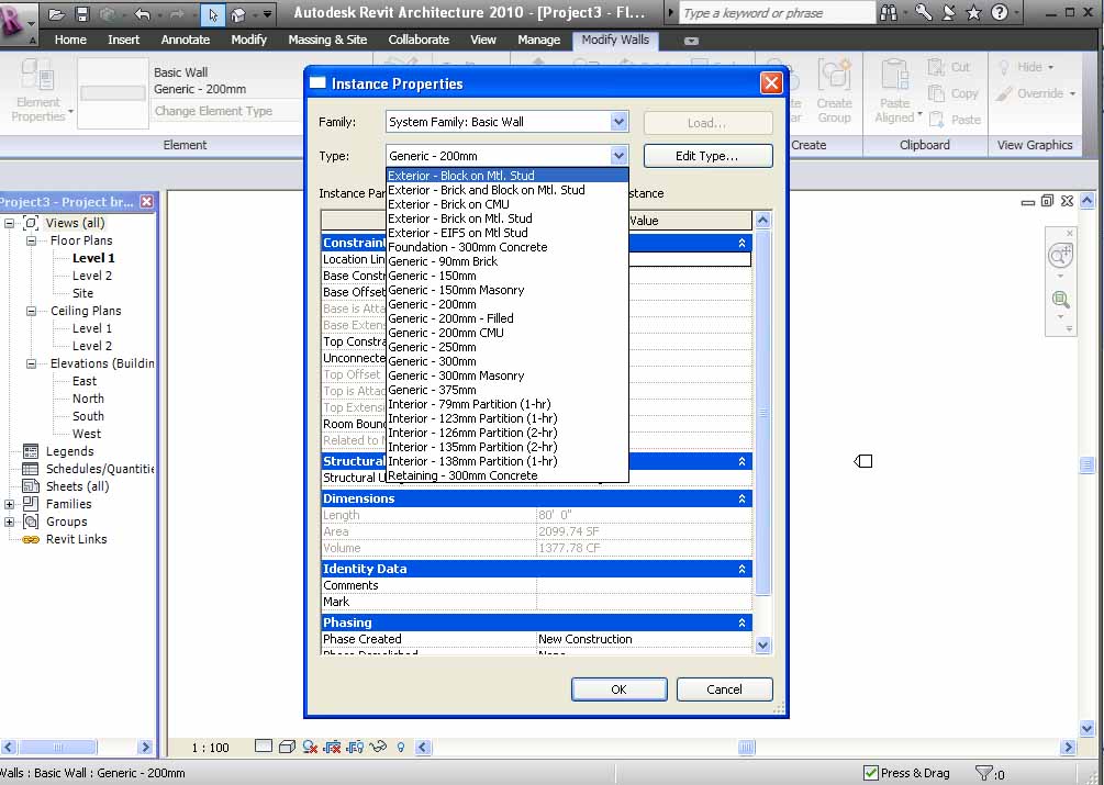

I just installed revit 2010 but unfortunatelly when I open an imperial template it shows me the walls in metrical system! I need the walls to be in inches Sad can someone please help me ASAP....Attached an image

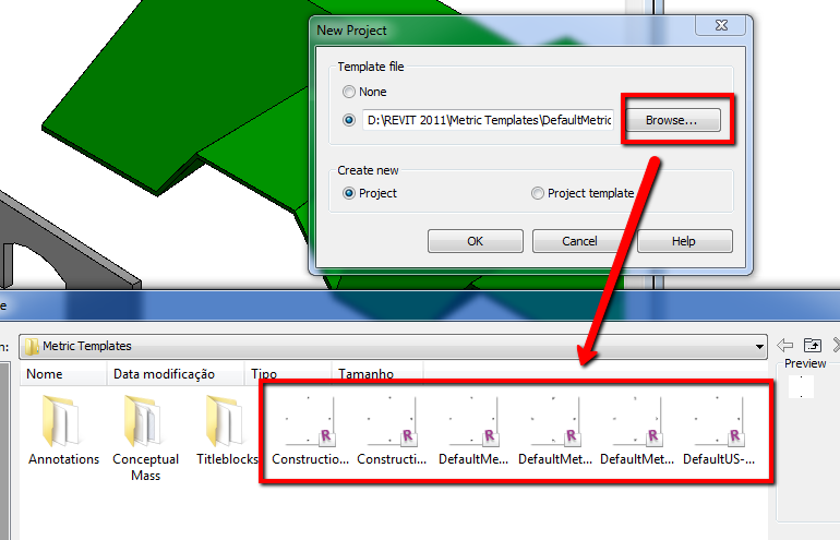

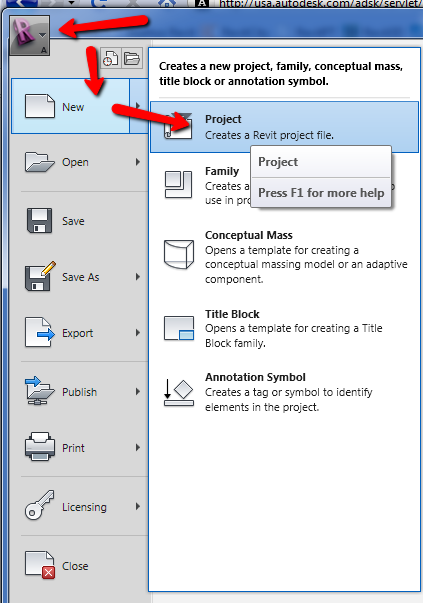

Go to the big "R" (like you can see in the first image) and select "new > Project" the browse and select the imperial template (second  image).
Fri, Oct 22, 2010 at 1:47:52 PM | HELP ME PLEASE! WALLS DO NOT APPEAR
mwtsilvia
Joined: Thu, May 17, 2007
4 Posts
4.5 Stars: 2 Votes
Dis it! the thing is I dont know why I had no imperial temlpates installed when I downloaded revit. I just download from the web page the nes  templates Smile
