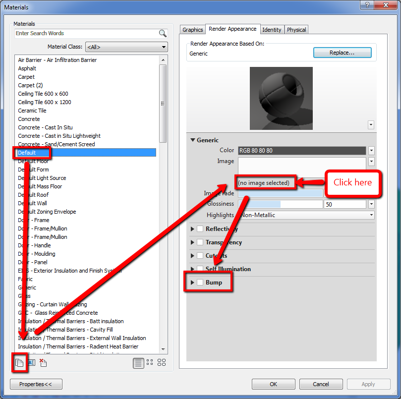

Go to materials, select a "Default" then duplicate, in render appearence you can change/apply a new image (jpeg) to the texture you want, then you can adjust the scale, rotation and so on...

Typhoon is right... you can also, add an "bump" map/image. that should give you what you want. Just play around with the settings and do some draft renderings.

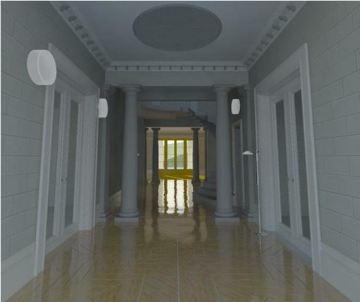

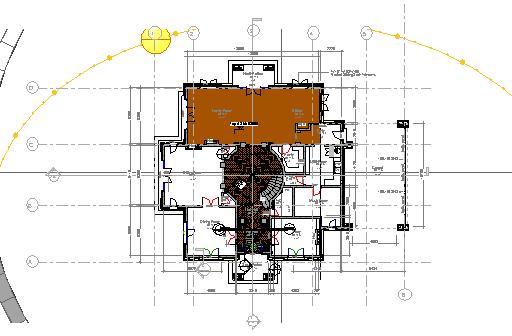

Thanks heaps you guys- I've played around with the woodgrains offered in Revit and attached an image to show where I am at. The difficulty is, (see floor plan), there is a star like pattern on the floor that I want to bring to life, and my renders still don't show definition in the pattern.
I somehow need to darken or define the 'grouting' or space between wooden planks......any ideas of howto do this? I feel like I'm drowning in the deep end here! Thanks so much so far..

Your images are too small, i can't see the problem but to define the 'grouting' or space between wooden planks you can create a sweep or a reveal in that floor, that sweep can have a dark color so when you render you will see the effect you want.
