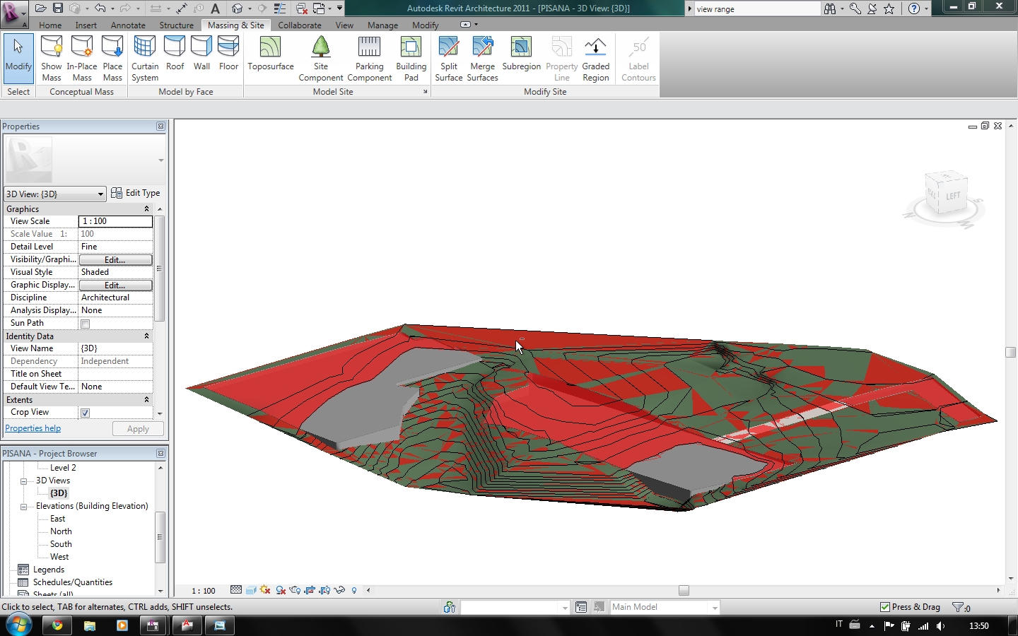

Hi!
Here it is how i see my project. How can i unsee those red parts?
They appeared when i create a graded region and keep remaining there after creating building pads.
I've started use Revit few days ago, so i still didn't know a lot about this program.
Thanks to everyone who will help me out!
I'm using Revit 2011.

Don't you have two "Topo" surfaces in that project?

Change your phase filter to 'Show Complete'
