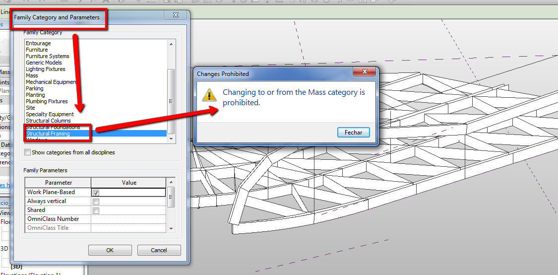

here is attached  the start of the first floor of my project, this first floor is half suspended, that´s why it has a beam on the low part....
1-I want to know how to convert this lower and upper beams made of  conceptual mass  in "real" beams (that revit can recognize them as structural components, assingn a meterial etc..)once I've exported it to a revit project.
I really need to now if I can do this in order to decide if it worths to continue or not..

1.  You can assign "Material" to those elements BUT you can't convert that to other category, in this case structural, like you can see in my image. I don't think this is a good idea to create this kind of beams in a "Mass" family.
2.  Just create a floor with the thickness you want and change the material to Glass.
