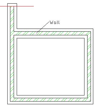

Hi all, I'm trying to make the continuous footing longer than the wall above it, but i simply can't find how to do it. on the pict, the red line is where the continuous footing stop, and i'd like to make it go further., does anyone know how to this ? Thanks

The footing tool is fairly new and not fully developed yet, it's quite limited. Just make your footings using the wall tool or make a footing sweep family. In your case you can leave the continuous footings around the closed perimeter and remove the footing on the open ended wall and replace with one of the methods above.
