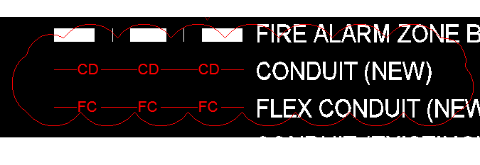

How can I create a new Line Style? Or how can I import one from AutoCAD? Attached is a jpeg of the line style that I need. it has the CD text in it...
Wed, Oct 13, 2010 at 3:06:54 PM | Line Styles
You can not do a line style with text in it in Revit.
Read this thread for an option: http://www.revitcity.com/forums.php?action=viewthread&thread_id=18549
