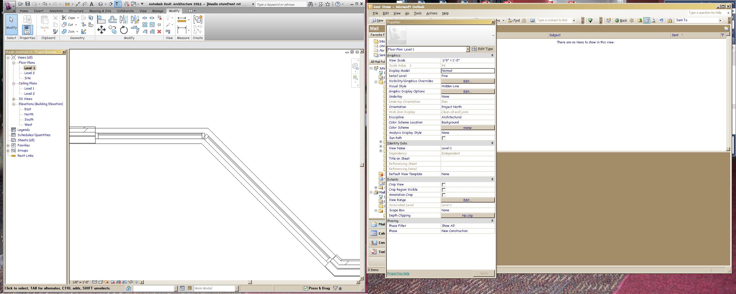

See the attached jpeg. Is there a way to make the horiz. curtain wall intersecting the 45 degree curtain wall into one mullion? Can I do a join wall? Or do I have to create a new family for that mullion? Please help.
Mon, Oct 11, 2010 at 3:57:57 PM | Mullion joining
We create a new mullion and plce it in only one of the curtain walls
