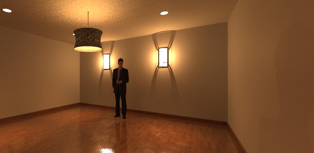

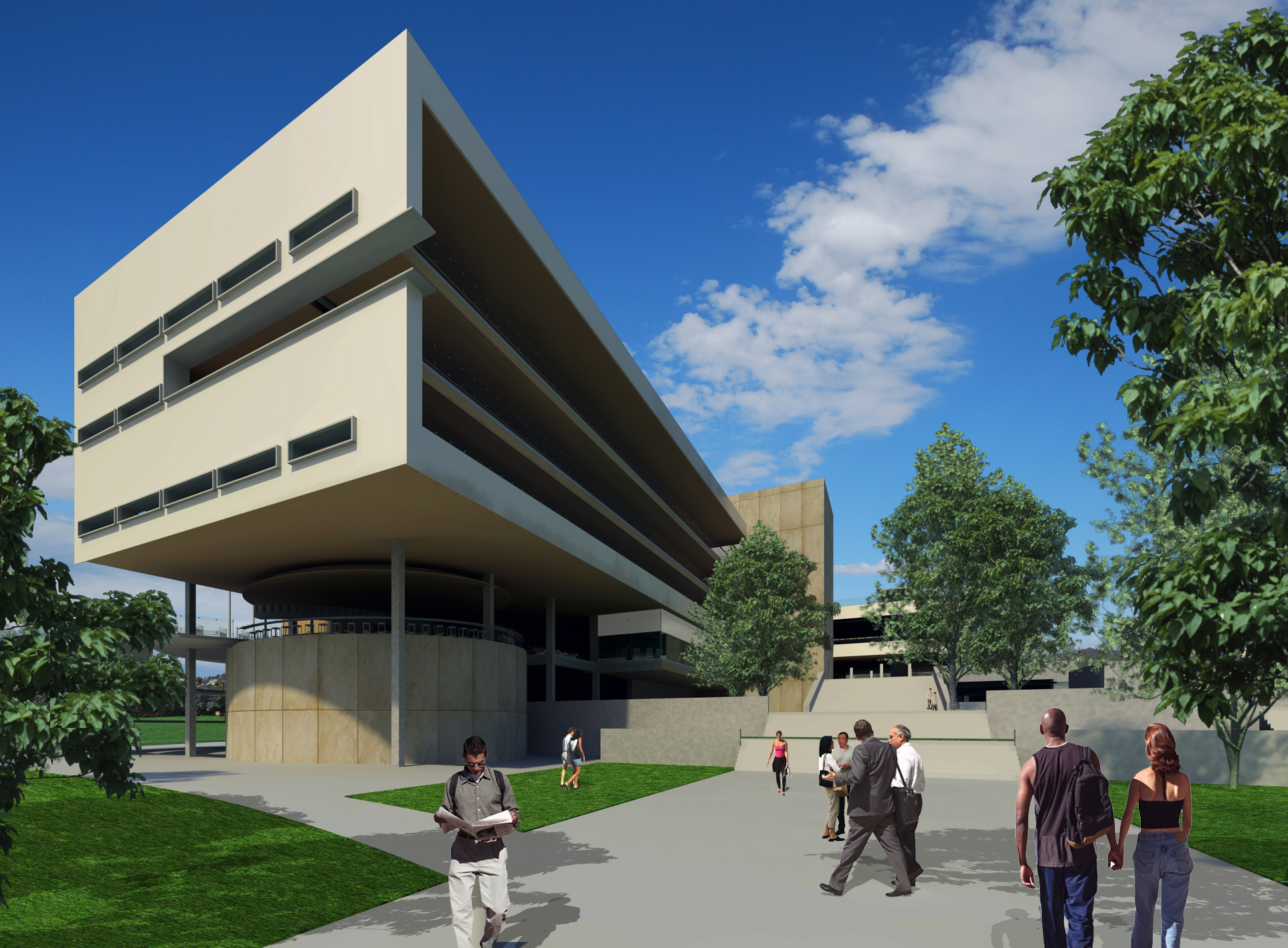

I'm somewhat new to Revit (loving it more and more), I just started to explore the rendering tools.  Does anyone know of some simple ways to add people to my Revit Renderings?  Should I just find some images and use Photoshop to add the people?  Any suggestions are welcomed.  (See attached sample).
Thanks.
mrDamon

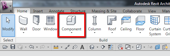

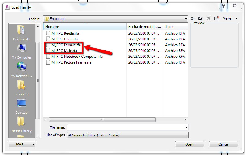

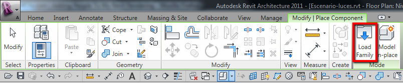

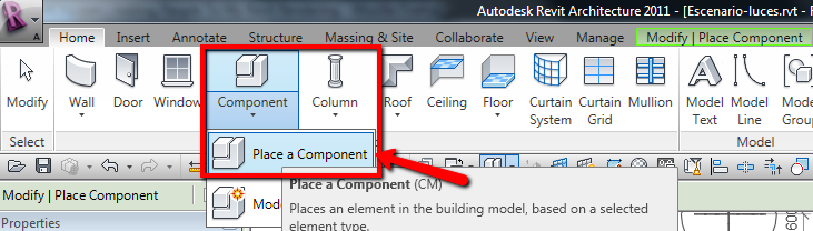

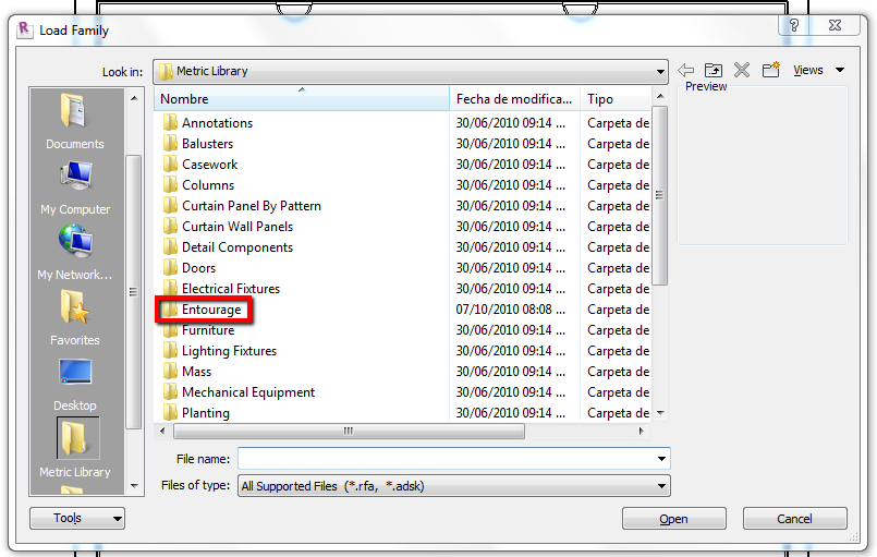

See the images attached.....You can buy RPC images from www.archvision.com, but they´re not cheap... You can also make your own. Read your HELP Menu.
83073_2010-10-072012.png83073_2010-10-072013.png83073_2010-10-072014.png83073_2010-10-072014001.png83073_2010-10-072015.png

And the result........

Fri, Oct 8, 2010 at 1:29:26 PM | erland73
Mr Spot
Mr Spot Avatar
Joined: Mon, Jan 12, 2004
2889 Posts
4.5 Stars: 93 Votes
Your person is floating... Puh
Quoting erland73 from 2010-10-07 21:17:35
"And the result........"
Regards,
Chris.
