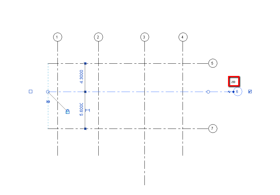

I was wondering if there is anyway to stretch the grids to different lengths in different views? In my current project I want the grid bubbles to be outside the Boundary line on the Site Plan (1:200) and closer to the building in all the Floor Plans (1:100). Is there a way to adjust this length without it occuring across the views?
 Any advice would be REALLY appreciated!

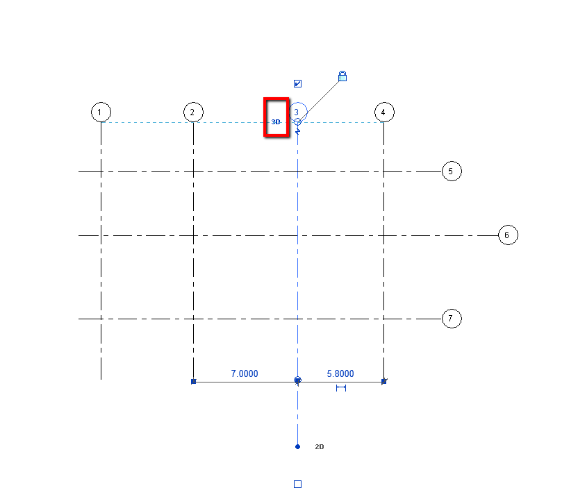

You can switch to "2D extents"  and then stretch the bubble or the end of that grid line to adjust that lenght like you want in that view.
I hope this is what you want.

Thanks so much! That was exactly what I was after! Smile Yipee
