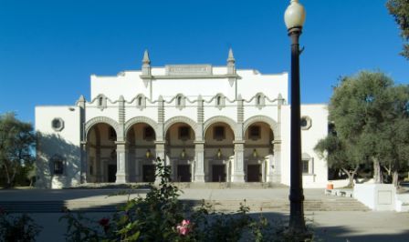

Is it possible to create a profile on a meandering sweep as displayed on this early 1900's Neo-Baroque school auditorium:

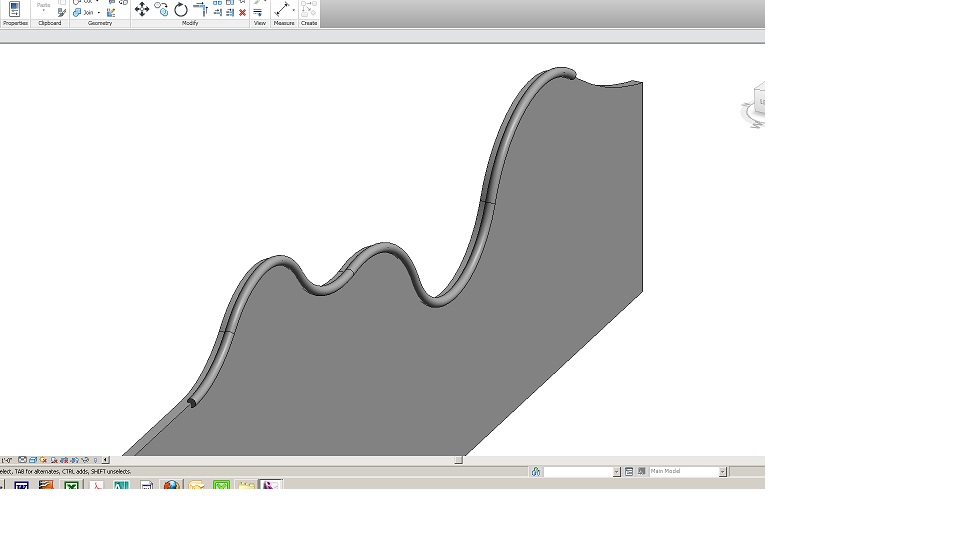

edited wall profiles *are* acceptable 3d edges.  Here's an example.

How are you able to make the sweep follow a 3D path?

To recap, When you model a family in place, pick a sweep.  Instead of selecting "sketch path" to start your sweep, you can use "pick path."  By default, you'll now be using the "pick 3D edges" tool, so, just start picking your path along a chain of 3d edges and you're good to go.  After you sketch the profile like usual.
