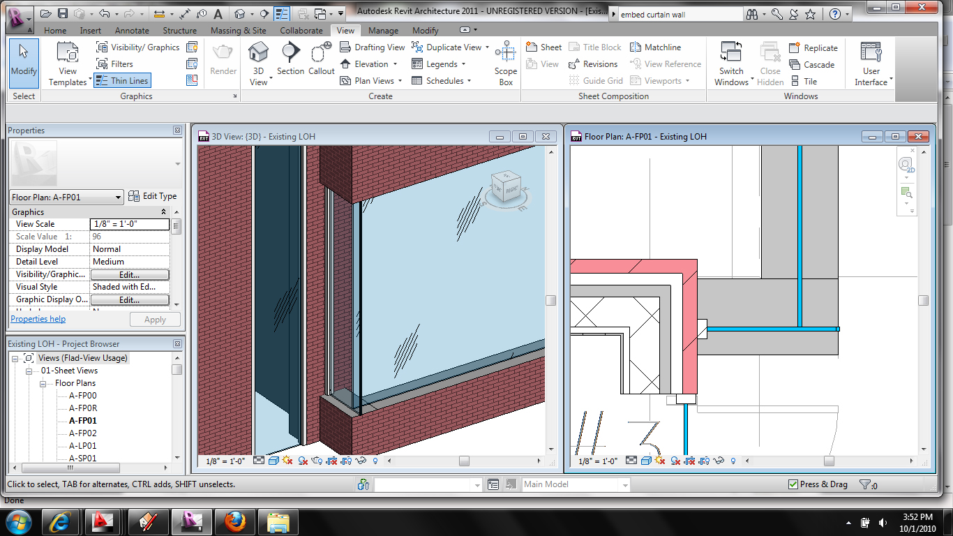

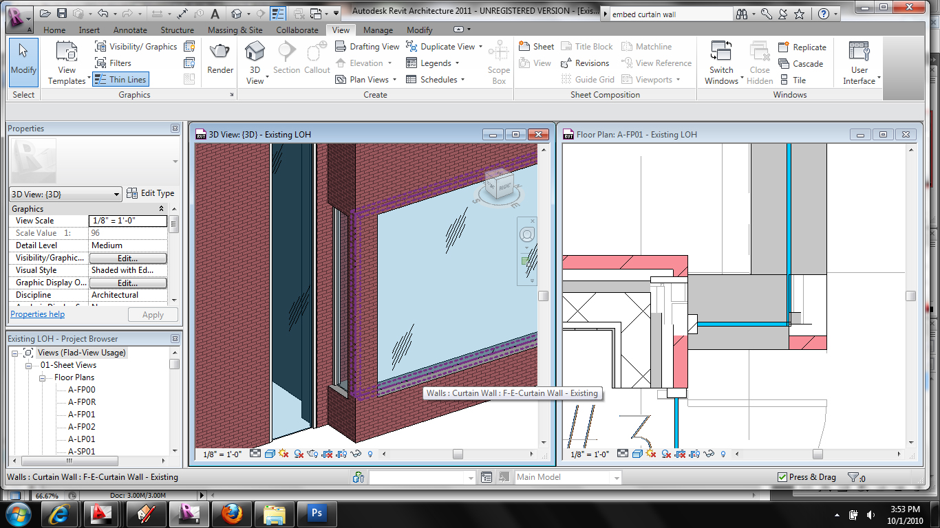

Well, I guess I have another issue. I tried the enbedded curtain wall and it works pretty good except for the corners. Here are two attached images showing the problems I am having. The curtain wall does not cut through the brick wall at the corner?
Only when I extend the curtain wall through the entire length of the wall does it work. which is shown in the second image.The problem with tihs is that the curtain wall is no longer correct.
 Any suggestions?

I placed a mullion there but this did not resolve the issue. Reading up on embedding walls, I have discovered that embedded walls must be shorter than their host. In this case, my curtain wall is the same length as the brick wall.
I will try doing this as a curtain wall with brick walls as panels. The only issue I think will come up trying to do this, is what to do with the corners to get the brick to turn the corner? Would I have to try and create some type of corner mullion that resembles the brick walls?

When we have a curtain wall that "corners", we extend one of the curtain walls to the edge of the intersecting wall so that the curtain wall cuts the corner.  Then we add a CW grid line where we really want the CW to end and we don't use any panels or mullions beyond that point.  (WE CHEAT <GRIN>Winking
