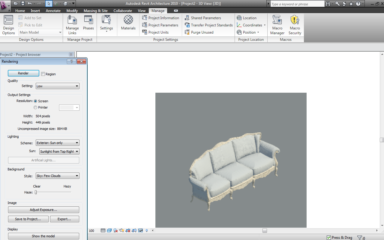

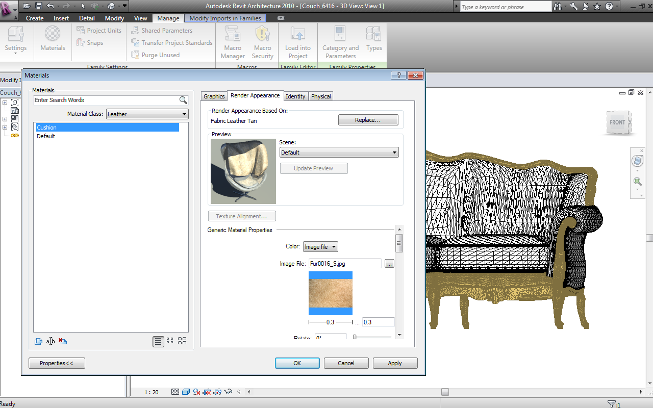

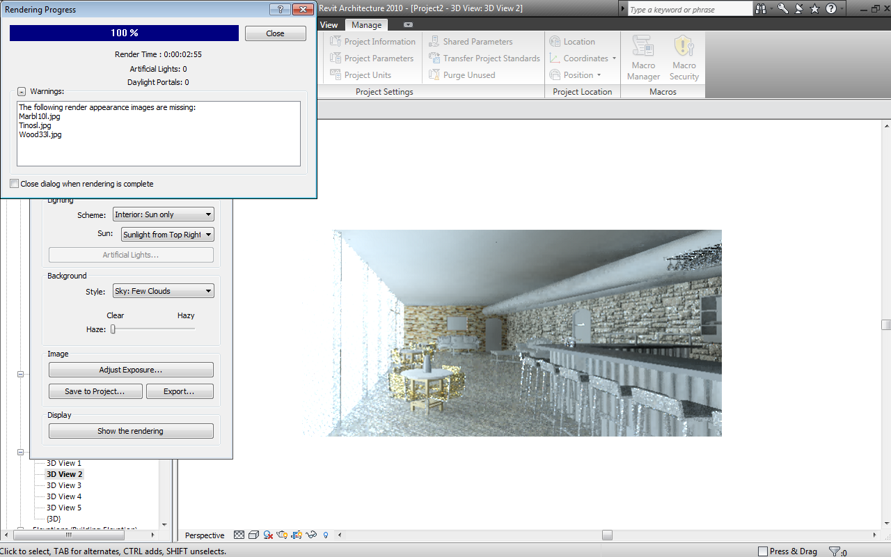

Hello everybody!Ive been using Revit 2010 for some time now,but now being the first time Im working with textures of my own,I couldn't exactly manage to apply them to my objects.I browsed through the threads I thought were relevant to my issue here,but no luck so far.F. x. the sofa next to the wall...here's what i do:
1) I select one of the cushions(in edit family mode), then go directly to materials in the manage tab,choose an unassigned material from the left column and then duplicate it,to make sure it won't put back any default material when I load the object into the project again.
2) Choose a render appearance category here,and choose an image to it.
Then load back into project and select to overwrite the family + the parameter values,but still comes out as grey as it possibly can.Any suggestions?
Thanks in advance!
P.S. On the rendering progressing window there're the warnings about render appearance images missing in objects that are no longer visible in the scene,though it still goes on rendering...

PROJECT RULE , in your project go to materials and check if you have the right texture (Material) in that objectc, about the missing images, where do you have those materials? in OPTIONS>Rendering do you have the path to those materials?

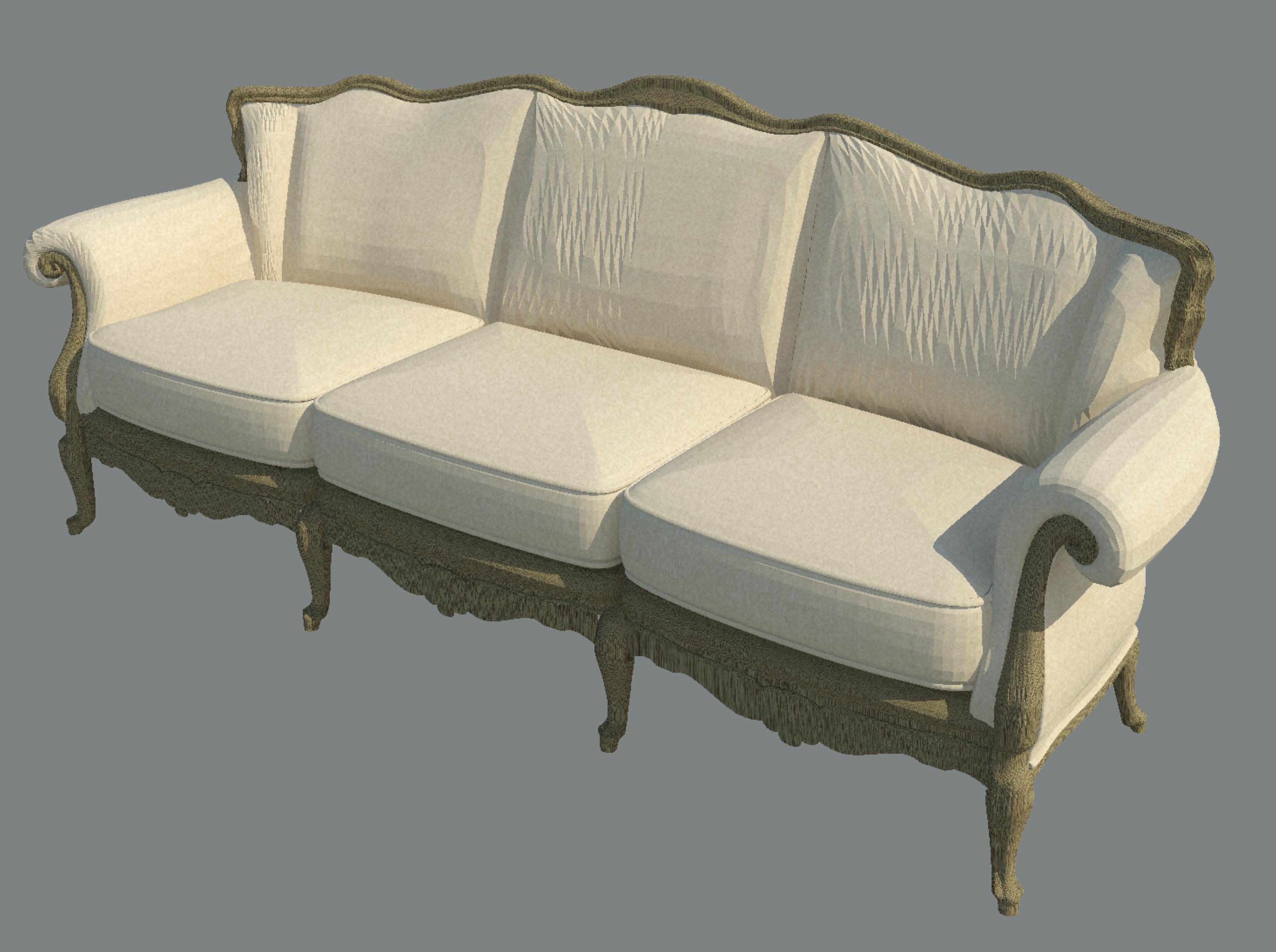

Thank you for your fast reply!This thing is starting to drive me nuts.Yes I checked if I have the right texture,did you see the image I attached?Now I transferred some of the textures to the right directory on the render appearance path,which I thought would make for some of the error or maybe it was the camera there was smth wrong with,but its the same outcome again...I tried rendering the object isolated,but it still renders with the original grayish colours (see the one below).Its the same with all the other new objects in my scene (the ones that do not belong to the library) and I think I might be adding the textures wrong...could it be so?

Don't know if this solves your problem but I've run into a similiar issue trying to render materials in RAC2011. I've found that some materials only render correctly if I, prior to opening Revit, delete the content of the Windows temp folder.

In your first image of that couch, in material box, i only see 2 materials, "Default and Cushion", i believe the "Cushion" is the "Wood" right? and the "Default" is what?? the rest?? i think you delete one material in that family...

Alright...I totally lost it now,the ones materials I created in the way i explained above,now are gone...Here's the family with the textures Ive just added along with the actual images.It'd be awesome if smbdy tells me whats going on here,what am I doing wrong.
Thanks,
Kaloyan =)

All of your dwg's are only layer 0.  Every 3D object in the dwg that has a different material needs to be on its own layer.  Then you assign the material to the layer in the object styles.

You mean I should take the Revit family into Autocad?Actually as it turns out the few texture i can get to see on that couch when its rendered is ONLY when it's isolated...back in the camera scene it renders solid gray again...

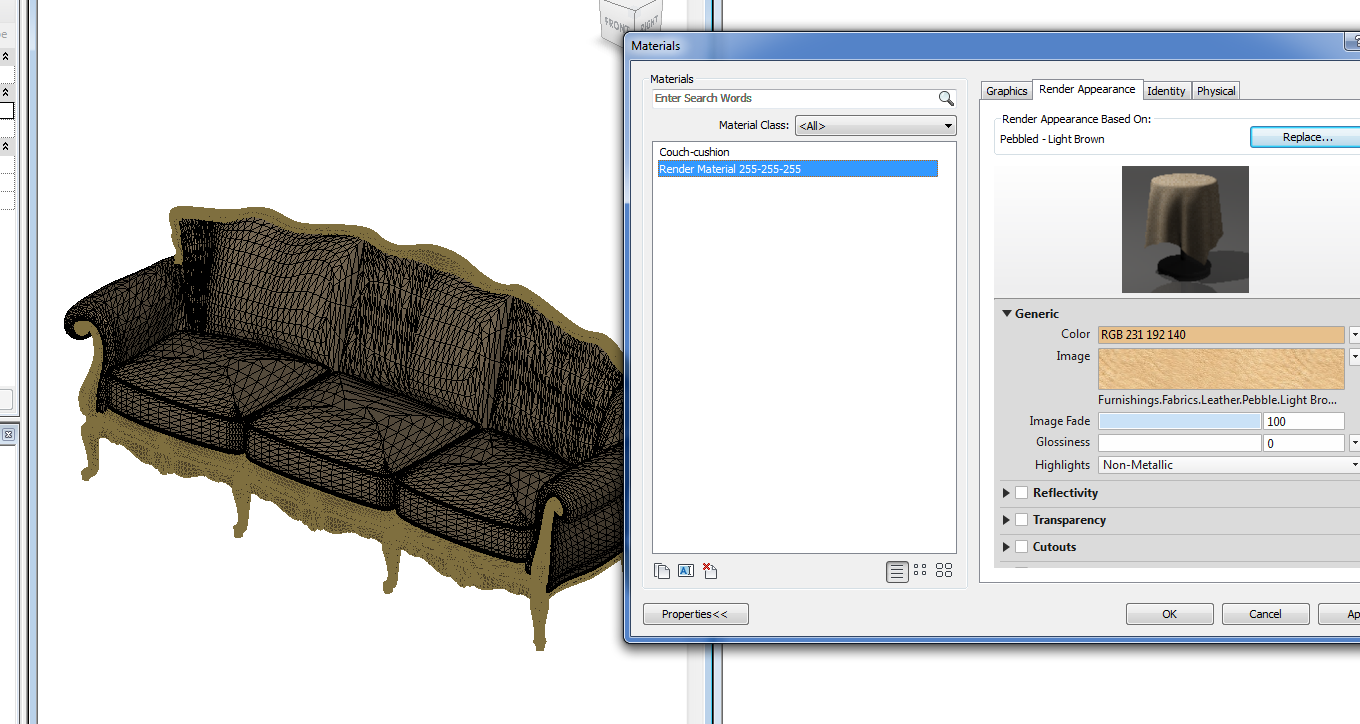

In your family, in materials, just change these two material like you can see in the image i attached. BTW, also, change that "Render material 255,255,255" to the appropriate name you want.

Typhoon just explained something that I did not see in this family.  The CAD file is actually many seperate CAD files  and each file had a seperate color assigned to the entity in it.   Thus you are able to assign materials by the assigned color created when imported into the Revit family.  Ty also thinks the original was created in Sketchup.
