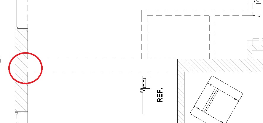

Hello there,
I am working on a project in which there are some walls will be demolished. The problem is some of the walls don't show probably on the plan. There is a line missing where the demolished wall joins with the existing one ( as shown in the image below).
I have been trying to show this problem for days I could not figure out how to do it probably. Before I demolish the wall I use the split tool to seperate the parts that will be demolished however it does not work.
Thanks for your help

Select the demolished wall, right-click on the blue dot at the end of the wall, and select Disallow Join.
