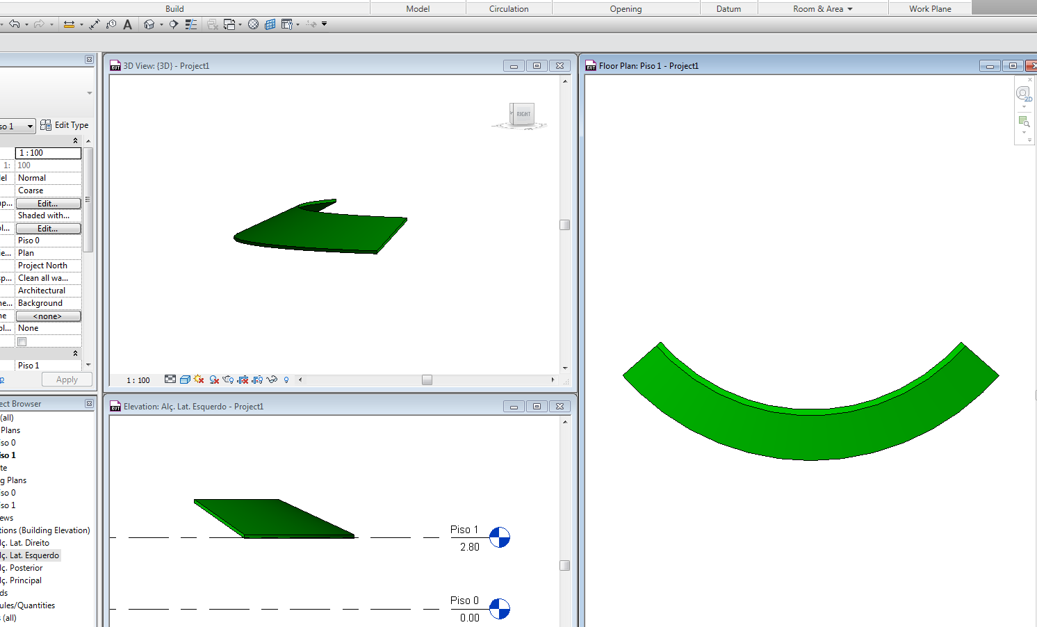

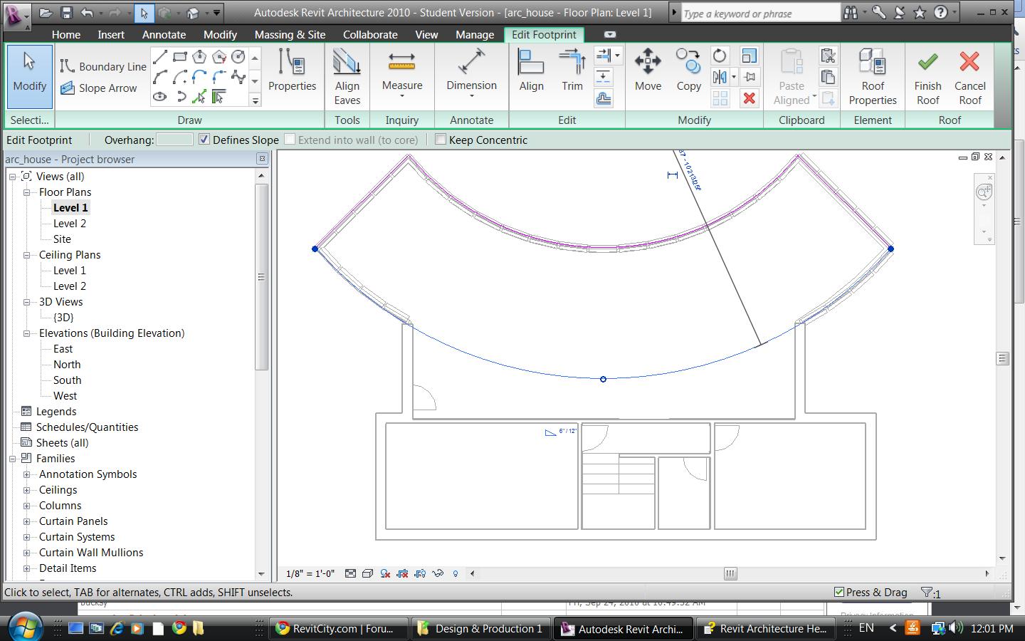

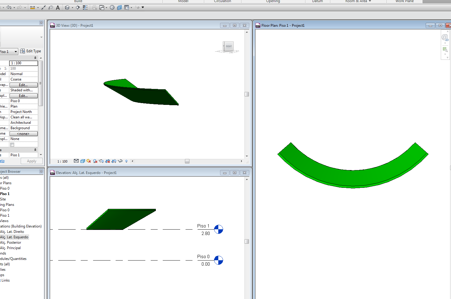

I want to create a shed roof for a curved wall.  It is giving me a error report  "Can't make footprint roof." when I click finish roof.  I was able to create a hipped roof, but when I removed the slope from the other walls and left one sloped side it gives me this error.

I don't have any problem with that, are you creating the boundaries OR did you use the "pick walls" option?

I used the pick walls feature, do you suggest creating the boundaries?  How did you do it?

Don't use the "Pick Walls", only draw the "boundaries"
