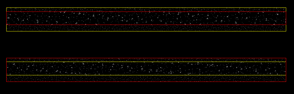

Hi All
I am trying to change the colours of an object so that it specifies different colours in the view. For example: The layers for floors are divided into- Structure [1], Substrate [2], Thermal/Air Layer [3], Finish 1 [4], Finish 2 [5], Membrane Layer, Structural Deck [1]. I want to assign a different colour to each each so when in in a section view, the floor will show the finish layers in yellow, the structure in red and substrate in blue. I have tried changing and adding subcategories to object styles but can't get to assign it to the corresponding layers. Is there a way to change this? All help will be much appreciated.

5 Posts
I have assigned materials to the slab, what I want to achieve is to be able to have the lineworks showing without having to change it again. It's part of a template. Attached is an image to indicate what I want to achieve and what I have achieved. The top slab is how I want it to look. The bottom slab is how I got it so far.

Wed, Sep 22, 2010 at 8:17:32 AM | Revit Layers
I don't understand your second post.  As Typhoon said... assign materials to each layer. ... and it appears that you have done that, so what is the issue?

3.5 Stars: 36 Votes
If I understand RT correctly he wants to control the color of the linework between the wall layers like autocad.
Not sure how that would work because techniclly a wall / roof / floor is made up of adjacent materials that share the same borders and the 'core' perimeter knid of has a mind of his own. I don't think the internal linework is that controlable?

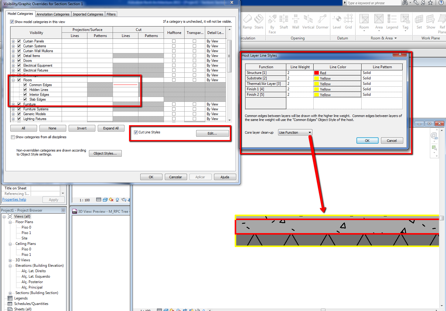

Wed, Sep 22, 2010 at 12:39:53 PM | Revit Layers
Joined: Tue, May 22, 2007
5921 Posts
4 Stars: 205 Votes
Is this what are you talking about?
Wed, Sep 22, 2010 at 12:45:55 PM | Revit Layers
dgcad
dgcad Avatar
Joined: Thu, Mar 17, 2005
1231 Posts
3.5 Stars: 36 Votes
Ahhhh forgot about that. Great find.
Wed, Sep 29, 2010 at 8:12:05 AM | Revit Layers
RTTAZZ
Joined: Tue, Jun 9, 2009
5 Posts
Thanks guys for the info. This is exactly what I have been looking for.
